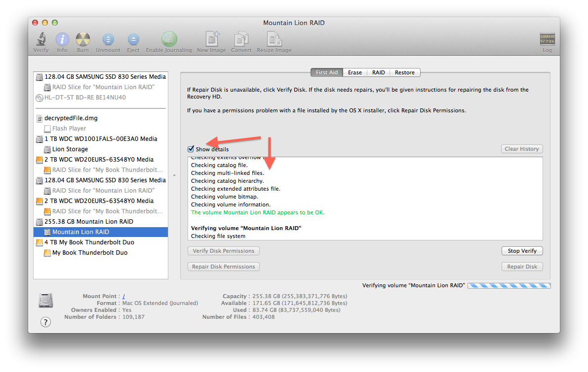

Also if you have Show Details checked in Disk Utility then it should tell you what type of problems were found, either with Permissions or Verifying the Disk.
