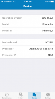

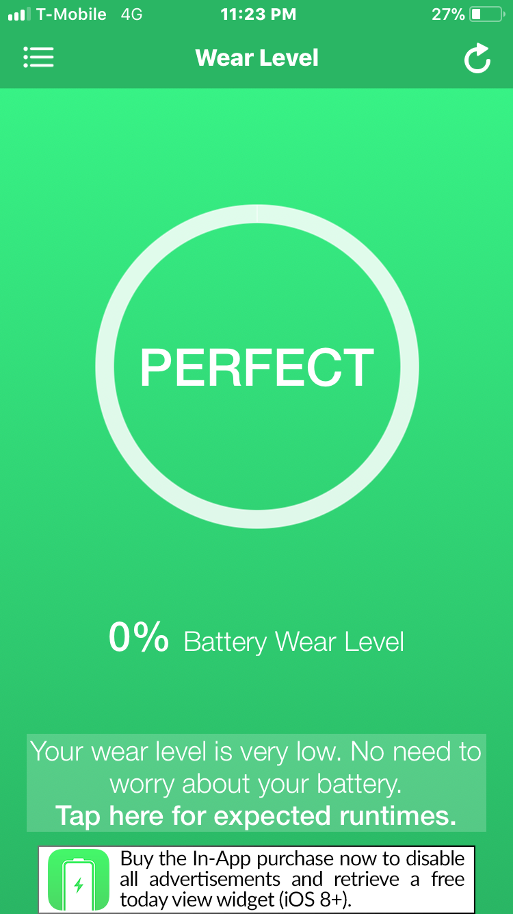

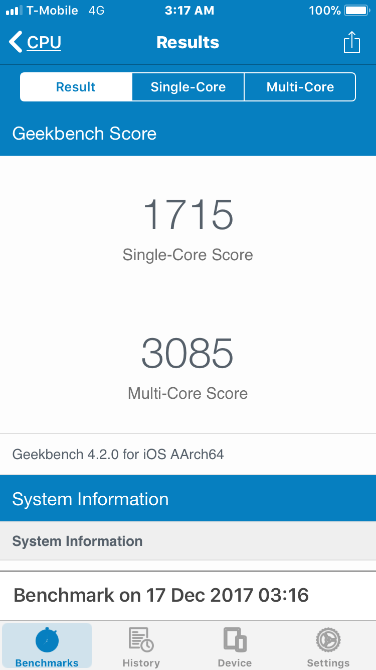

Does your phone feel slow? If you take and edit a 4k movie in imovie, is it reasonably fast? I'm wondering if the phone feels okay, but somehow the benchmarks are throttled.
Yes it does feels slow, i haven’t tried the iMovie app yet, but I downloaded CPU DasherX and when my battery is at 100% runs at 1200mhz, in 90% or below goes down at 911mhz is strange, I’m going to try with another battery and see what happens.

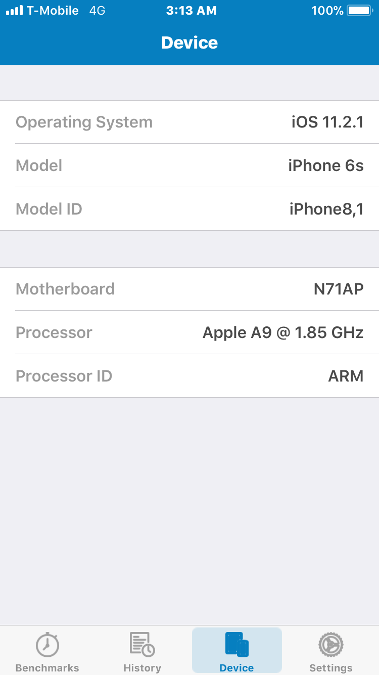

Now my cpu frequency is high and my benchmarks too after replacing my battery from another one that I bought from eBay, it looks like the first battery was giving lower voltage causing the cpu to throttle, I’m happy now.
Now my cpu frequency is high and my benchmarks too after replacing my battery from another that I bought from eBay, it looks like the first battery was giving lower voltage causing the cpu to throttle, I’m happy now.
look like good numbers to me, similar to the ones on my 6s with a new apple battery. CPU speed is same.

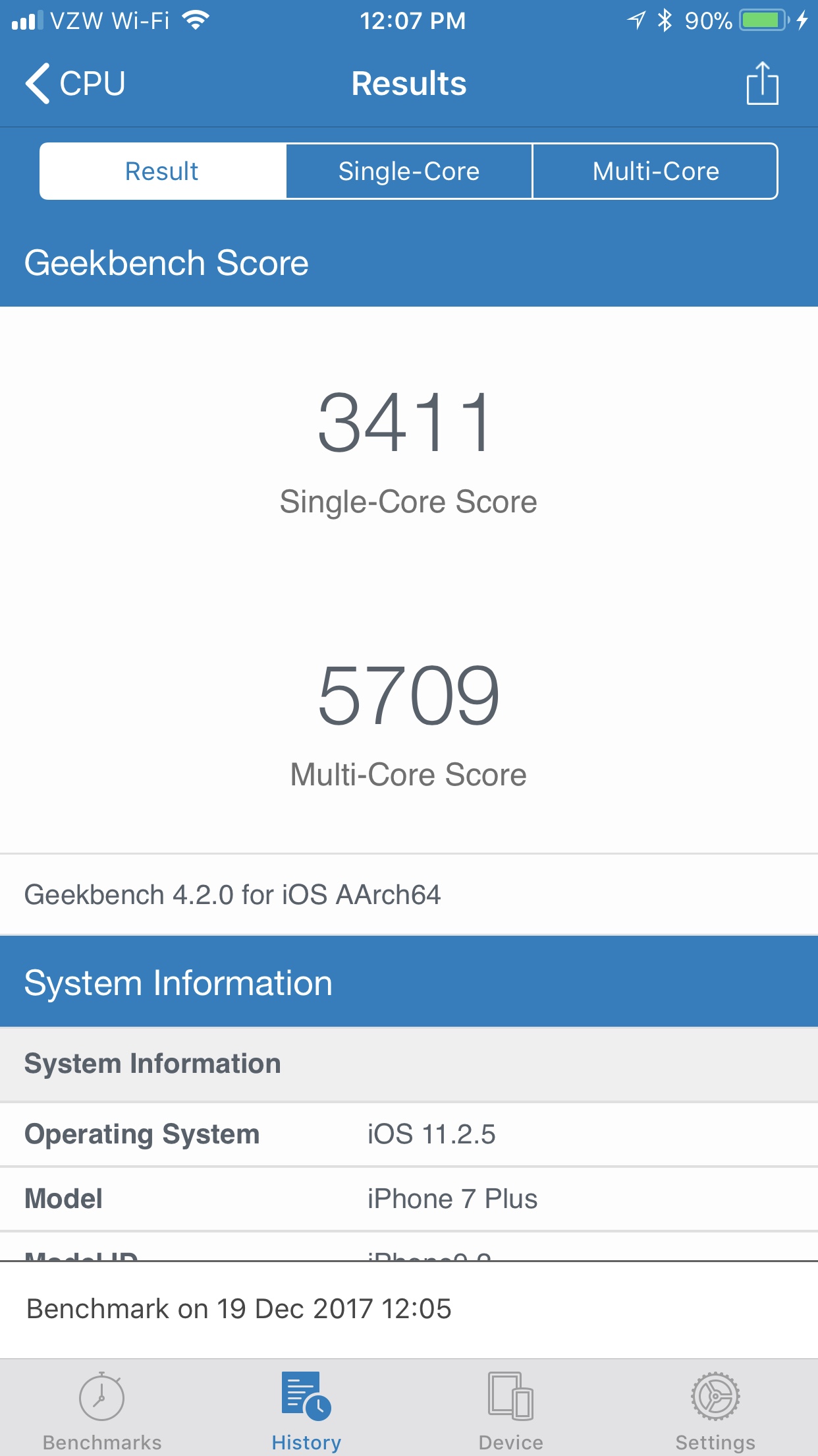

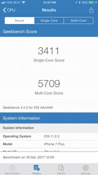

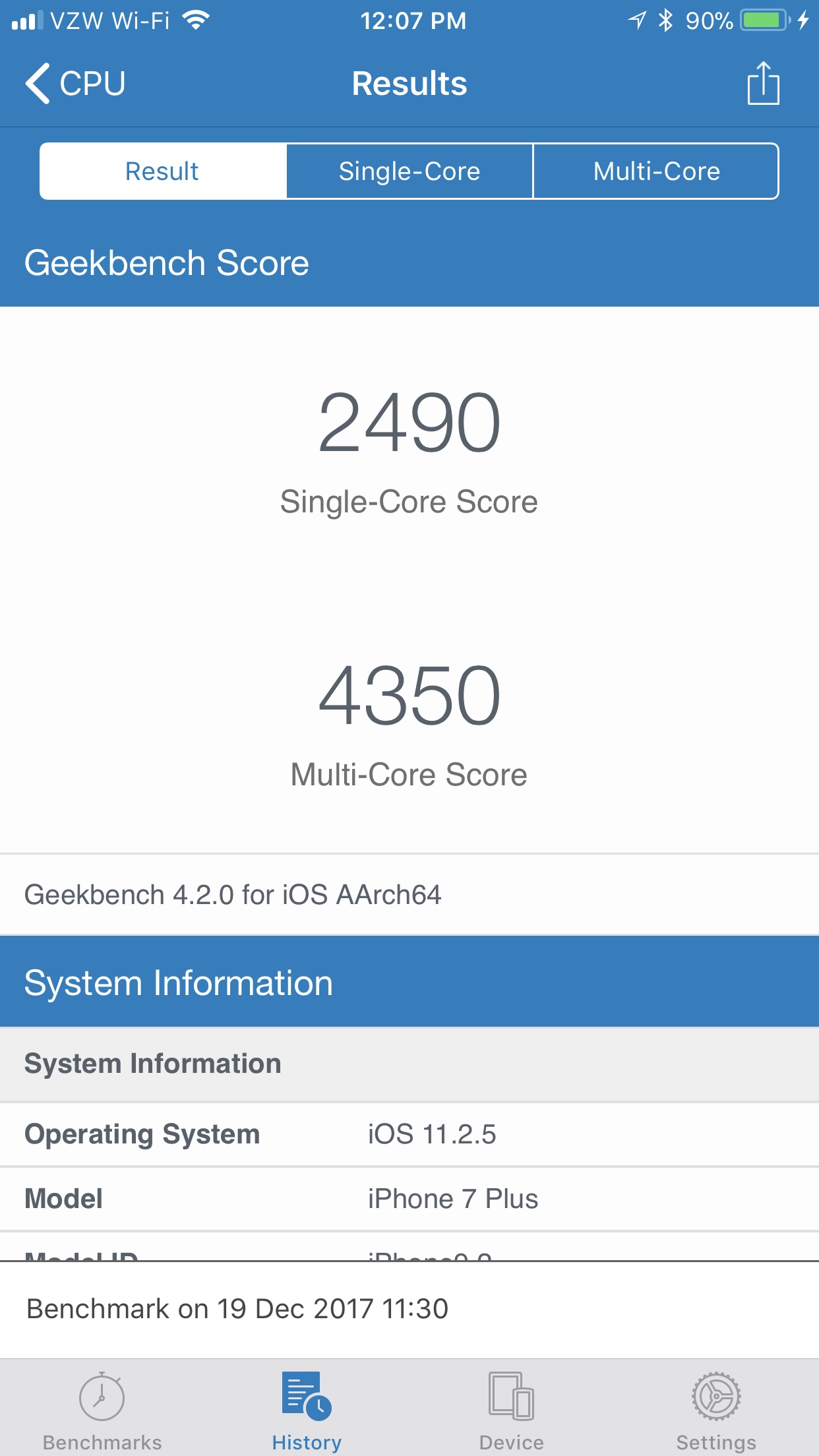

I think there is definitely some throttling happening. I ran Geekbench both at 50% and 90% battery life and the results were very different. when the battery was lower the score shaved off over 1000 points off my score! My battery health hovers between 85-90 percent so I don't know why its being throttled.
View attachment 742745 View attachment 742746
I think the thing is, as I'm seeing on my 7 and was mentioned elsewhere in the thread, is that when the battery capacity is lower (e.g. my capacity is 1710 mAh, vs. 1960 when it was new), you'll get full CPU at higher battery charge % (75% and above), but lower CPU as the % drops. Can you see what your capacity is, and how many charge cycles you've done?

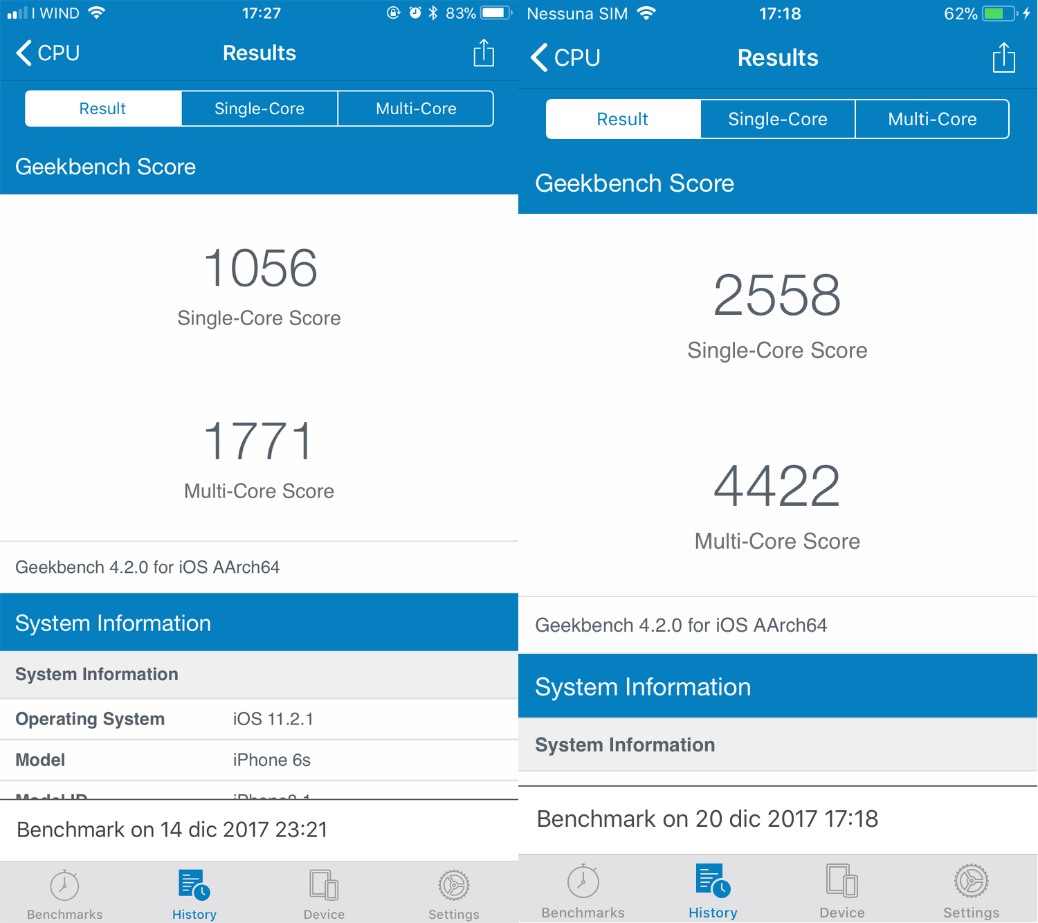

I' have been following this thread since the beginning and now I can add my personal experience.
I recently bought an iPhone 8 Plus so I took the occasion to test this battery/CPU situation on my now "old" iPhone 6S.
It is a day-one heavily used device.
I went to the nearest Apple Store and asked for a battery replacement.
They tested the device and told me that, even if I was willing to pay, they couldn't authorize the maintenance service because the battery was still over 80% capacity.
I went straight to a third party maintenance shop and with 50€ (half the price asked here in Italy by Apple for the same service) had the battery replaced within an hour.
Now look at the difference on Geekbench!
