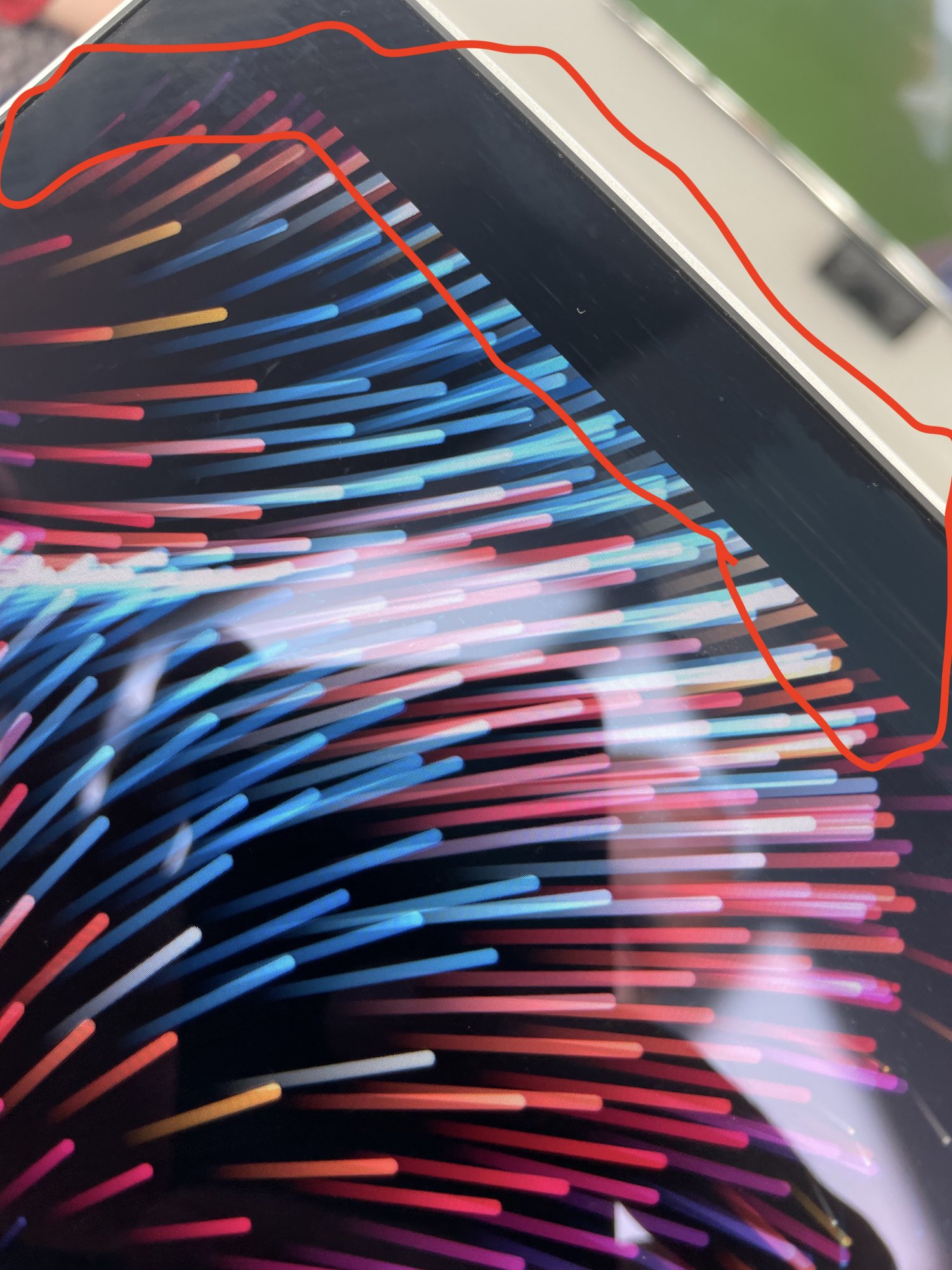

This is what my brand new MBA M1 Looks like! Having Apple replace it now.
