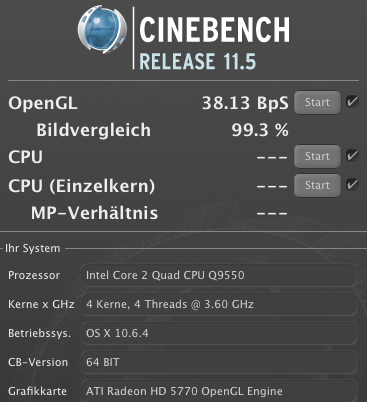

Problem 2 monitors and HD 5770
had the same problem in the hackintosh world (rig is similating a macpro 3.1)
Only first monitor came up , second monitor went black after late graphic update .
problem solved .
incorrect framebuffer was inserted ( Motmot = ATI 4xxx series)
correct framebuffer for HD 5770 is Vervet ( Uakari for HD 5870)
I corrected framebuffers : Now 2 Monitors are working fine even with 1080p HDMI @ 50 Hz (Panasonic Pro Plasma)
Unfortunately I cant test displayport , but I think its working too.
HD 5770 (custom bios) Candy :
Rank 1 in Cinebench 11.5 Database Mac

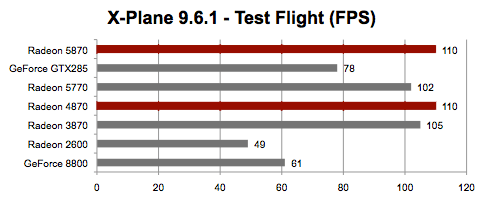

The only game my 2008 Mac Pro could need some extra horsepower is X-Plane.
I already have the Radeon 4870, and notice the pic below.... (testmachine Mac was an 08 Mac Pro)
