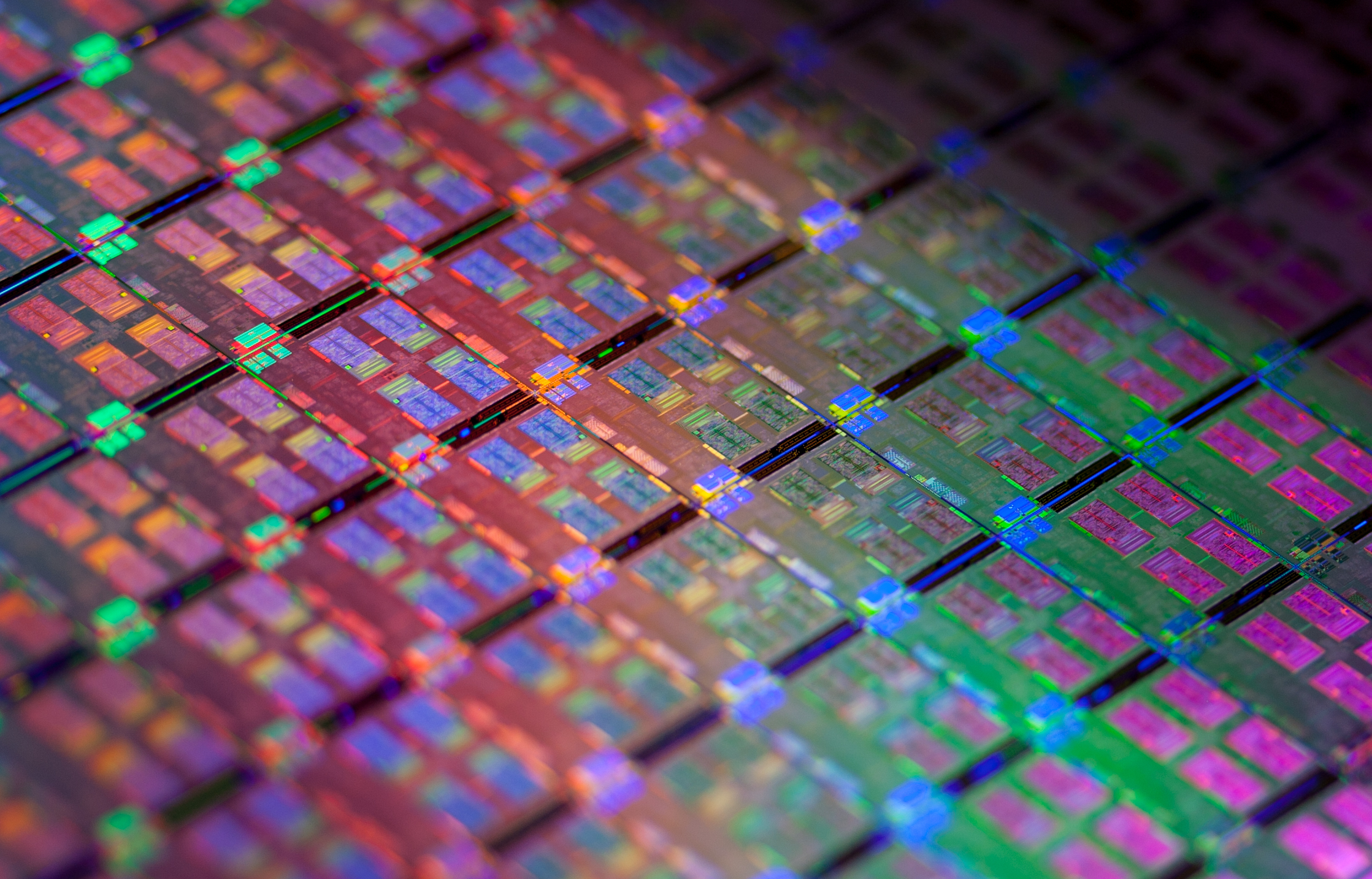

Apple's chipmaking partner TSMC today announced its intention to build and operate an advanced semiconductor factory in Arizona, with construction planned to start in 2021 and production targeted to begin in 2024.
The facility will be able to manufacture around 20,000 wafers per month using TSMC's latest 5-nanometer fabrication process. TSMC has been gradually miniaturizing its process over the years, going from a 16nm A10 chip in iPhone 7 models to a 7nm A13 chip in iPhone 11 models. iPhone 12 models are expected to use a 5nm A14 chip.

I think it is supposed to be wafers, not chips. It wouldn’t make sense to spend $12 billion to make even 2.4 million chips per year.
If we assume 200 chips per wafer (that's a *really* rough guess, but likely correct to within an order of magnitude at least) than that's 4 million chips per month. Not enough for iPhones, but enough for Macs (and then some). 🙂

20K Wafers - not chips. Wafers and chips come in different sizes which affects yield.
Each 300mm wafer has around 14,500 chips. Maybe 70% will be usable.

14,500 per wafer is way high. Your earlier number of 500 was likely much closer to correct. My own 200 number was definitely low.
So assuming 500 per wafer, that's 10 million per month. Still not iPhone numbers, but more than enough for Mac chips plus maybe iPad Pro chips. Or some for other customers.
This article seems to be full of errors. Says 20,000 chips when by all accounts it is 20,000 wafers. Number of chips depend on size of chip and size of wafer.
It also says that apple's A series chips have been progressively getting smaller. The process has been, but the chip die has not.

But the range, including the X variants, is 83mm2 to 144mm2. And for the non variant ones, 83mm2 to 104.5mm2. Not a huge variation. The great benefit of process shrinks is that you get more transistors into any given area.

My mistake. Honestly, I clearly don't know much about chipmaking, as I thought a wafer was synonymous with a single chip. I have updated the article! Thanks
