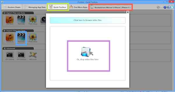

After installing iFunBox, start it and let it recognize your iDevice: the area annotated with a red rectangle below should show your iDevice's name:
(as always, click for the original-sized, high-quality screenshot)

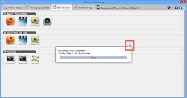

Now, click the Quick Toolbox icon at the top (annotated by a green rectangle above) and, then, select “iPod video” (annotated with blue above) in the “Import files and data” group.
Then, just drag-and-drop the videos you'll want to transfer onto the new dialog that is displayed (annotated with a purple rectangle). After starting the import process, when the progress bar reaches 100%, you can safely close it with the “X” icon in the upper left, annotated with a red rectangle below:

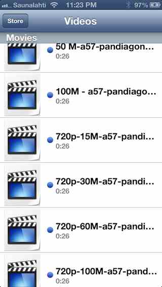

The Videos app won't generate thumbnails for the list view. An example screenshot (also showing my high-framerate and, for the most part, high-bitrate test suite I use for benchmarking the new HDMI adapter):
