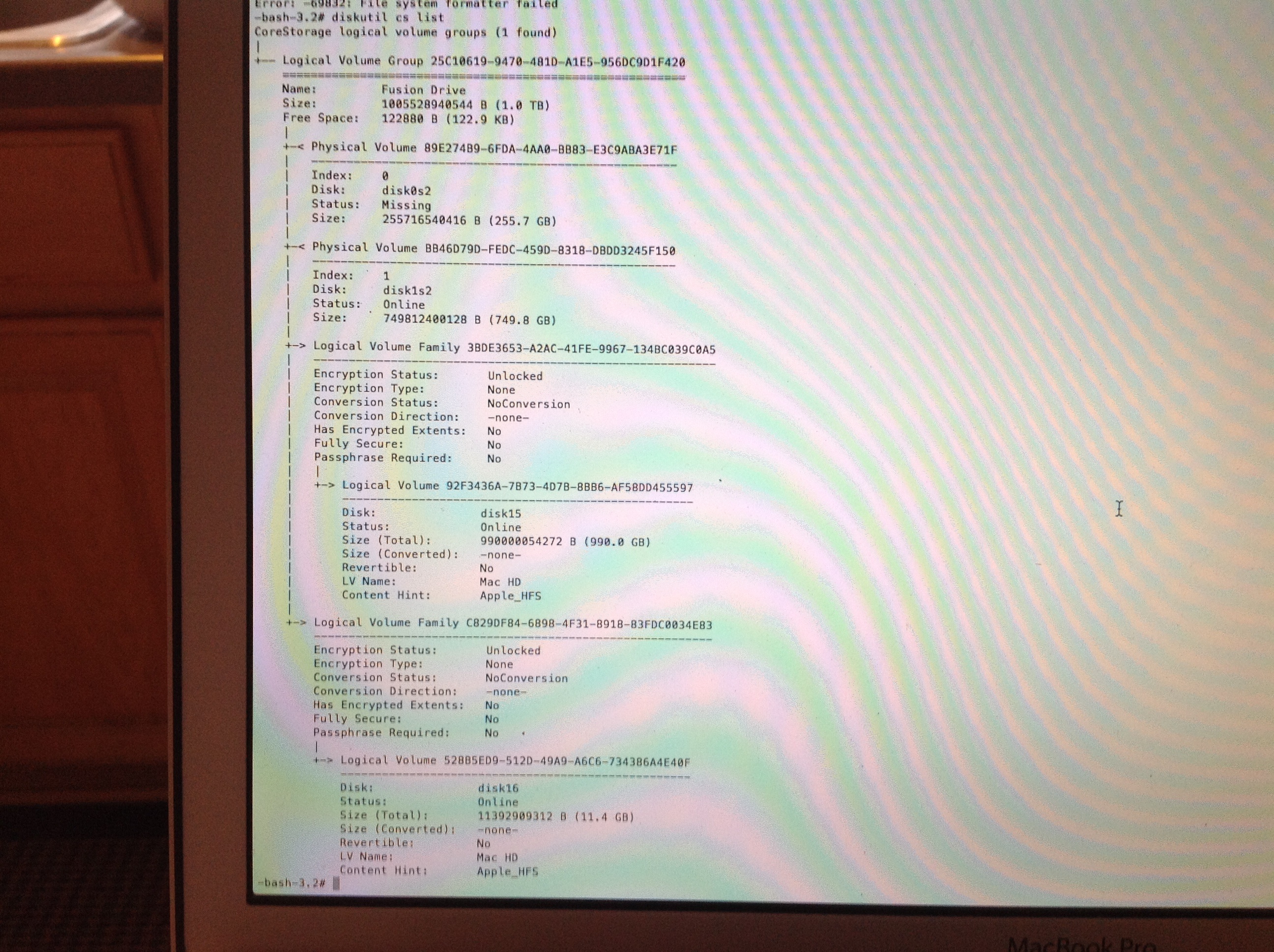

Could someone please tell me what I'm doing wrong in setting this up? I've got a 2011 MBP with a Samsung 830 256Gb on the main drive bay (6gbps) and a Seagate XT 750 installed in the optical bay (3gbps). I'm booting 10.8.2 from a USB stick and entering terminal where I get the bash prompt (I don't know how to get the TIN> prompt, is this part of the problem?) At the prompt, I type:
"diskutil cs create MacHD disk0 disk1"
All seems to go well, except when I enter disk utility I cannot format the newly created volume (because its "locked"), so if I go back to terminal and enter:
"Diskutil cs list"
I see my volume and associated ID. I figure it needs to be formatted, so I follow the next part of the guide and type:
"Diskutil coreStorage createVolume (UUID) jhfs+ "Mac HD" 990g"
I get a error "-69780: Unable to create a new CoreStorage Logical Volume"
After that, my SSD drive disappears and I can no longer even boot from my USB stick! The only way to recover is to take out the hard drives and reformat them in another computer! Ugh!
What am I doing wrong?

Are you sure the SSD and HDD are disk0 and disk1? from what you say in the end it seems the USB stick is one of those.
I'm positive. Once I remove the drives and use disk utility to "fix" them on another Mac, the USB drive boots perfectly.
Maybe the correct is:
"Diskutil coreStorage createVolume (UUID) jhfs+ Mac HD 990g"
When Disk Utility "fixes" them they are Logical Volumes and not Physical Disks.I think that you have to delete the Logical Volumes before you create a new Group.And if you type in Terminal :diskutil cs list you'll see Logical Volumes and not normal disks
This is normal

But then why is it not working? I'm still getting this same error and disk utility is unable to erase or partition because the volume is "locked". Is it because I'm using the Momentus XT or a cheap eBay optical bay? I've tried multiple times and always get an error and an unbolt able system. I really wanted to get this working and I believe I'm doing everything correctly, but I've now tried at least 5 times and am about ready to give up.
if you type
Diskutil cs list
what is the output?
I tried it again and it seemed to work, but starting disk utility caused the SBOD. Subsequently, as before, I can't even boot the USB installer until I remove the drives and reformat them on my wife's computer. So I can't get into terminal for the output. Seems like something is terribly wrong that fusing the drives causes my system to not boot from my USB flash drive (I get the SBOD).
I'm going to give up. If this unsupported configuration is so unstable on my system, I think I won't tempt fate and will go ahead with plan B, keeping my main apps and OS on the SSD and photo library, etc on the second drive. I'm very disappointed, but I've now done this multiple times exactly as instructed and it is just not working.
Is there a "safe boot" USB option so I CAN get into terminal?
Maybe it doesn't like the 990g number? You could try substituting 100% instead.

if you type
Diskutil cs list
what is the output?
I tried it again and got the same errors. Here's my output attached.
ok now type
diskutil cs delete (Volume ID)
where(Volume ID)=25C10619.....
Thanks, but it won't boot again to the flash USB installer. I get the apple logo and then the circle with the slash through it. I can't get back into terminal since I shut the computer off. I'm used to building hackintoshes, this should not be so hard. Maybe there's a reason Apple hasn't enabled it for all? Maybe it's flaky on some systems?
Maybe...
but you have 2 Logical Volumes (The SSD status missing) and I think that the Disk Utility can't partition the disks because they are Logical Volumes....
Maybe you have to delete the Logical volumes in other computer but as they are i don't think you can work
Yeah, the 2 logical volumes were created by formatting in terminal which ended in the aforementioned error.
