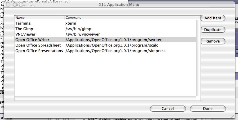

Add them to your Applications Menu
In X11 you have an Applications menu. At the bottom is Customize... Use this to add the commands to start OpenOffice and you can start them easily. See attached screenshot for mine:
