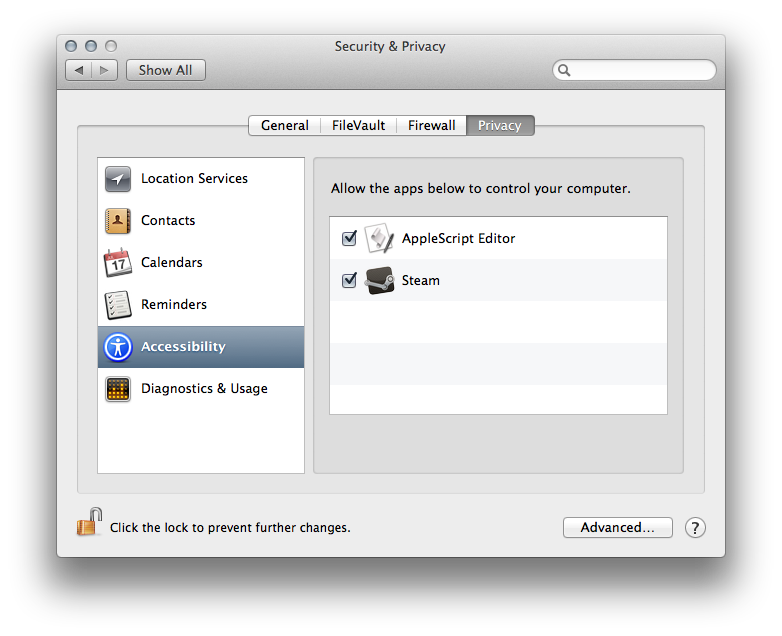

Make sure AppleScript Editor is allowed to control your computer. Check System Preferences --> Security & Privacy --> Privacy tab.
This example worked for me on Mavericks with Max version 0.9.1 :

I actually found the security feature just before you posted this. The problem now is the check mark doesn't stay checked for very long under "hazel" Any thoughts?
