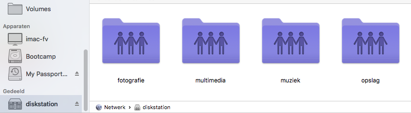

I’ve just switched from Windows to mac (and I’m happy with my decission!).
Now, I’m trying to write an apple script to make a folder on my external hard disk (NAS). My hard disk is mounted, I can see the following in Finder. The disk is called ‘Diskstation’ (As you can see, I’m dutch speaking)

What are the names of the shares on the Diskstation?
I have the following partitions/shares: fotografie, multimedia, muziek & opslag.
