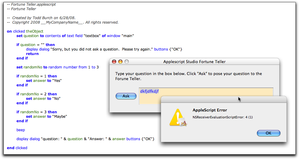

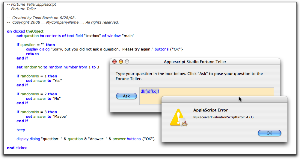

I'm working through an example (my 2nd one...) in a book and I keep getting an error when I click the button that is associated with this code block below. The line in red causes the error NSReceiveEvaluationScriptError: 4(1). I've typed it out just like in the book.
I'm using Applescript Studio to create the app.

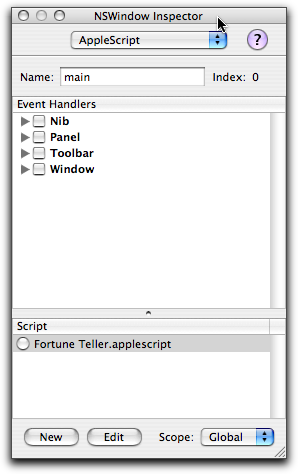

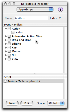

In Interface Builder, or otherwise, how to I determine where the name "textbox" or "main" get associated with the NSTextField or NSWindow? I expected to see them under the Inspector "Attributes" view, but I didn't see them under any of the Inspector views.
Code:
on clicked theObject
	[color=red]set question to contents of text field "textbox" of window "main"[/color]
	if question = "" then
		display dialog "Sorry, but you did not ask a question.  Please try again." buttons {"OK"}
		return
	end if
	set randomNo to random number from 1 to 3
	if randomNo = 1 then
		set answer to "Yes"
	end if
	if randomNo = 2 then
		set answer to "No"
	end if
	if randomNo = 3 then
		set answer to "Maybe"
	end if
	beep
	display dialog "question: " & question & "Answer: " & answer buttons {"OK"}
end clicked
I googled the error and found several hits, but most pointed to poorly behaving applescripts that others had downloaded, and I'm pretty sure I don't have any of them.
I also use the Xcode debugger, thinking that it might show the button or text field attributes, but I didn't see them there either.
Thanks!

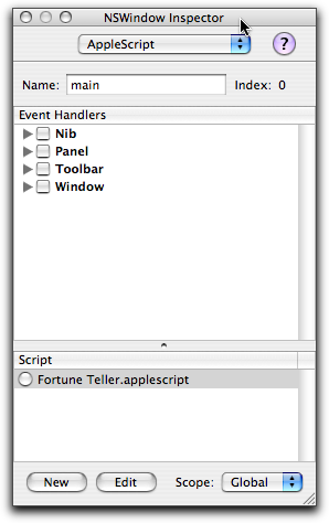

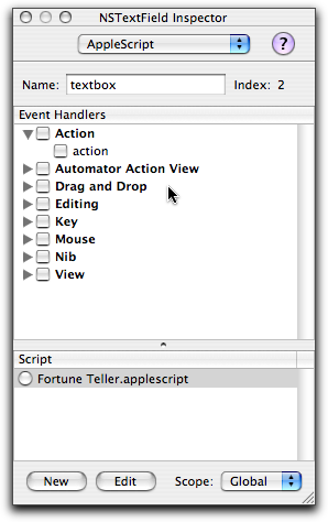

Nevermind, I figured it out. A shortcoming in the book.
In the Inspector, under the Applescript view, there is a "name" field. I entered the names from the example into this field for both the Window and the Text Field, and that fixed the problem!
