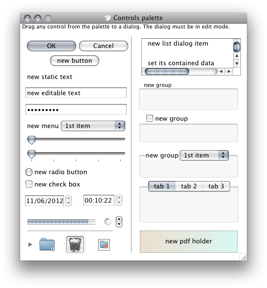

Red Menace beat me to it. You can also use Smile to build custom dialogs.
