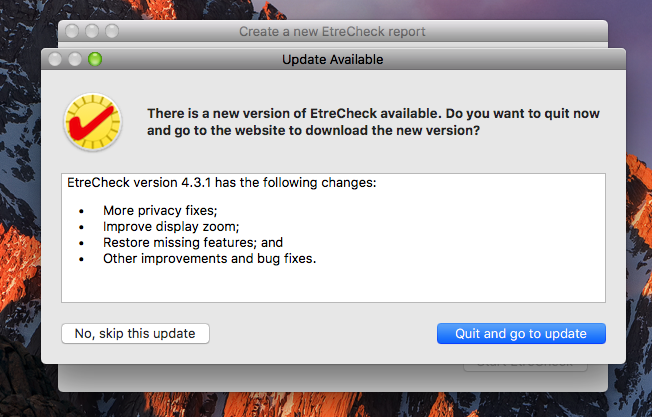

My problem is I want to use an older version of "EtreCheck" on my older MacPro hardware, and each time I fire it up I get a window offering me to update.
I've contacted the author and he tells me as long as I'm using this earlier version I'm stuck with the window.
I'm sure someone with the skills could whip up an AppleScript to launch EtreCheck and supply the necessary action to close this annoying popup.
Is this possible? Any help would be appreciated.

I think the steps are:
1. Work out the attributes (names) of the Update available window and the No, skip this update button (using something like the UIElementInspector).
2. Create a user interface script using AppleScript, probably something like:
Code:
tell application "EtreCheck"
activate
    tell process "EtreCheck"
        tell window 1
            click (first button where its accessibility description = "No, skip this update")
        end tell
end tell
3. Save the script.
4. Enable User interface scripting for the script.
The script would then launch EtreCheck, wait for the Update Available dialog and click the required button.
That should be all you need but I can't add any more info unless you post the version of EtreCheck that you're using.
Hope this helps...

I got UIElementInspector working then downloaded a version of EtreCheck. It's obviously not the same version as the OP but enough for me to learn the principles of creating a user interface script.
Following examples elsewhere and checking the element names with UIElementInspector, I came up with this:
Code:
activate application "EtreCheck"
tell application "System Events"
        click button "Skip" of window "Update Available"
    end tell
end tell
It seemed to work once but now I think I must have imagined this because it fails every time with:
error "System Events got an error: Can’t get window \"Update Available\" of process \"EtreCheck\"." number -1728 from window "Update Available" of process "EtreCheck"
I've tried numerous variations but no joy because I don't understand why the script can't get the window.
I'm not too disheartened 'cos this is my very first AppleScript but I would like to know if I've made a very basic error. Any help would be greatly appreciated.

I've not tried this myself, but perhaps you could approach the problem another way? If you were to open the app as a package (ctrl-click it and select "Show Package Contents) then there should be an info.plst file.
My *hunch* would be that if you hunt for a version number in there and change it to something very large then you'll stop getting the dialog. For example, if it says:
Code:
    <key>CFBundleShortVersionString</key>
    <string>1</string>
...then change it to...
Code:
    <string>1000</string>
Make sure you use a text editor e.g. BBEdit/TextWrangler, not Word or anything like that!
I'm guessing that the app compares its version number to some kind of record online (web service, rss or something) and if your version is lower than the record online then it tries to update. If you pretend to have a much higher version then it may be fooled into not asking you to update.
Make sure you have a backup of your app in case Something Bad happens.
Interested to know if that works!
