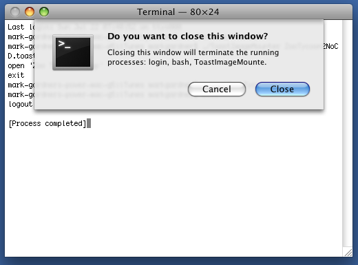

I am using the following script:
Code:
tell application "Terminal"
	activate
	do script "cd /Volumes/iTunes/" in front window
	do script "./ToastImageMounter ZooTycoon2NoCD.toast" in front window
	do script "open 'Zoo Tycoon 2.app'" in front window
	do script "exit" in front window
	close front window without saving
end tell
It prompts me to click on the close button in the terminal window, and still leaves terminal active in the dock. what modifications would you suggest? If I could I wouldn't even have a terminal window at all.
You can use do shell script from Standard Additions - see Technical Note TN2065. Note that each do shell script statement runs in a separate generic shell, but a semicolon can be used to separate multiple commands in a single statement. Using && to separate commands will stop later commands if there is an error, for example:
Code:
do shell script "cd /Volumes/iTunes/ && ./ToastImageMounter ZooTycoon2NoCD.toast && open 'Zoo Tycoon 2.app'"
