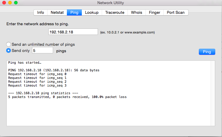

I have written a script that pings my iPhone's IP address to determine its absence or presence but have run into three problems [for now...I am sure I will run into more down the road]:
1. I cannot for some reason successfully ping my iPhone when wirelessly connected to my LAN. I do not why this is happening as I can ping my Win 7 laptops, etc.
I attached the results of my ping attempts.
I would appreciate any and all assistance in solving this because without this working I don't know how else to test the absence / presence of my iPhone.

As as item 1. is concerned here is some added information...
The script that I have written is as follows:
try
Code:
set IP_address to "192.168.2.18"
	set ping to do shell script ("ping -c 2 " & IP_address & "| head -2 | tail -1 |cut -d = -f 4")
	if ping contains "ms" then
		set iPhoneDetected to "True"
		display dialog ("iPhone Detected - " & ping) buttons {"OK"} default button 1 with title "iPhone Detection Test"
	else if ping contains "timeout" then
		set iPhoneDetected to "False"
		display dialog "iPhone Not Detected " buttons {"OK"} default button 1 with title "iPhone Detection Test"
	end if
end try
The interesting thing is that:
a. If my iPhone is connected to WiFi when I open [i.e. first run the script] then the script does may / may not detect the iPhone.
b. If my iPhone is not connected to WiFi when I open [i.e first run the script] but later turn the WiFi on then the iPhone is always detected...if I then toggle the iPhone's WiFi off / on then it similarly successfully detects the iPhone.
It seems to be a problem detecting the iPhone when the iPhone's WiFi is on [i.e. not toggled] even though the iPhone's IP address is reserved [i.e there are no lease issues].
This is incredibly frustrating because I think it should be working in that when I change the IP address to the IP address of my laptop then the script works perfectly when I toggle the WiFi on and off..why not for the iPhone? This is so frustrating...
