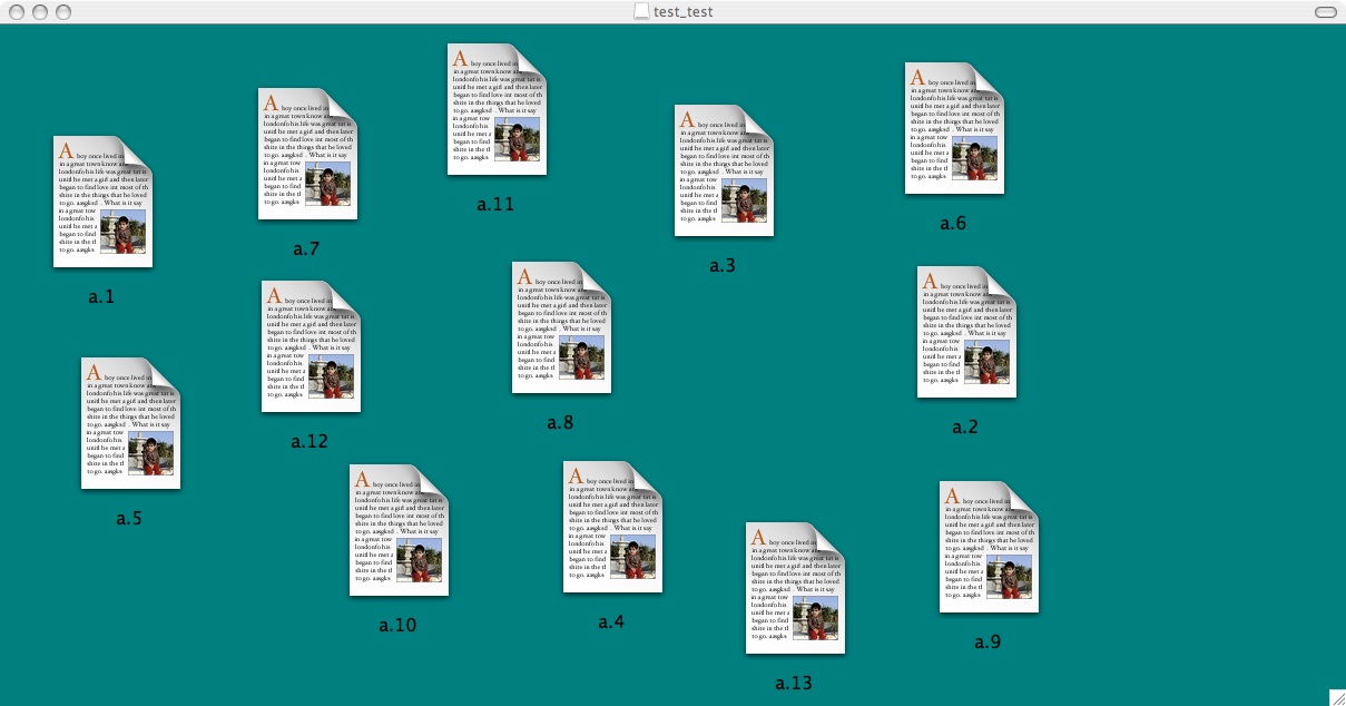

It seems to work OK to me, but I may be misunderstanding the intention. I attached an image, at full resolution, of what I get on my system. It seemed to be what the script was asking for.
-Lee

OK, no solution yet, BUT...
I put delay 2 between each positioning... and it seems that it thinks the objects are being positioned "off" the window... and when that happens, it adjusts the position of the "working area" of the window, so the coordinates are not relative to each other, only relative to the position of the "working area" when they're particular set position is run. I'll poke at it a bit more, really not familiar with this stuff.

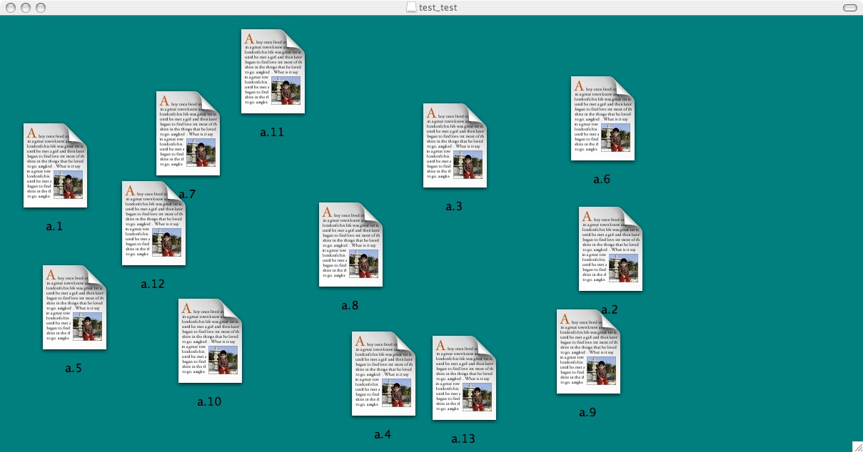

I tried adding x and y, no dice. that was even worse. I'll poke at it a bit more later. I'm not sure if the coordinate you give is the center of the icon, or the top right, or the top left, or what. If it's the center... you shouldn't position anything within 64 pixels of the sides, since you have the icons set to 128x128.
-Lee
p.s. I don't know what it should look like, but adding 64 to each value in each coordinate seemed to be better than the way they were before. i attached the resulting window with that change.

I FOUND IT!!!!
A) you have to add 1/2 the icon size to both the X and Y coordinates
B) the Left edge of the Icon (or its label) cannot be less than 13 pixels from the left edge
C) the Top of the Icon cannot be less than 10 pixels from the top of the window
Do all of those things.... and it lines up PERFECT... at all icon sizes
B & C are both After you have done "A"
