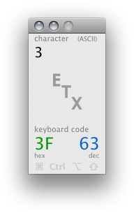

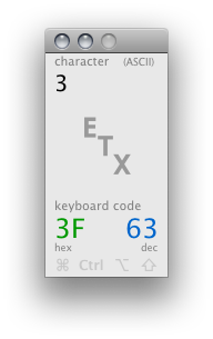

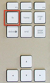

The result of pressing Funtion + Return together on my AZERTY Belgian Aluminium Apple keyboard reveals decimal 63 in the Full Key Codes application.

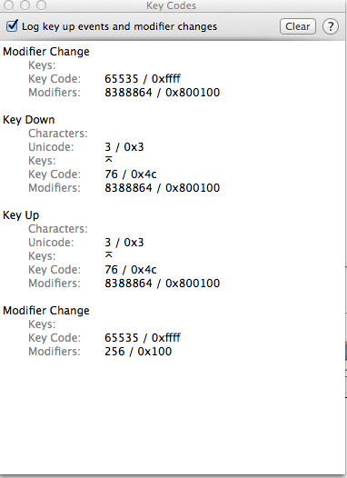

Yes, that is the same function key that is in your previous post. I have attached a screen shot from the "key codes" app that I downloaded.
