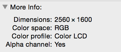

Maybe i'm coming from wrong direction.....
I'm trying to find out what anything that comes after KDMItem if it refers to anything .... ie,, does WhereFroms refer to a tag name "Where from:" or what ? how does it get this tag if its not coded ? etc..
Once i know this., i can adjust it to my needs. But its the only thing i'm stuck on.
I tried adjusting the WhereFroms to my own tag name, but noting happened..
For example using shell script from code to delete "Author" tag in a music file. so I had KDMItemAuthor ,,
but it didn't work
The com.apple.metadata:kMDItemWhereFroms in your sample is the name of an attribute that has been assigned to a file. You need to know the name of the specific extended attribute you want to remove from the fileToClean file, and then use that name after the '-d' replacing the entire com.apple....Froms string. Using "xattr -l filename" as suggested earlier will give you a complete list of the extended attributes assigned to that file.
Are you sure that what you want to modify is an extended attribute? I just looked at a few music files (m4a and m4p) and the only extended attributes I see are related to Finder. Author sounds more like metadata that would be embedded in the music file itself rather than an extended attribute, which would be accessed via some other mechanism.
