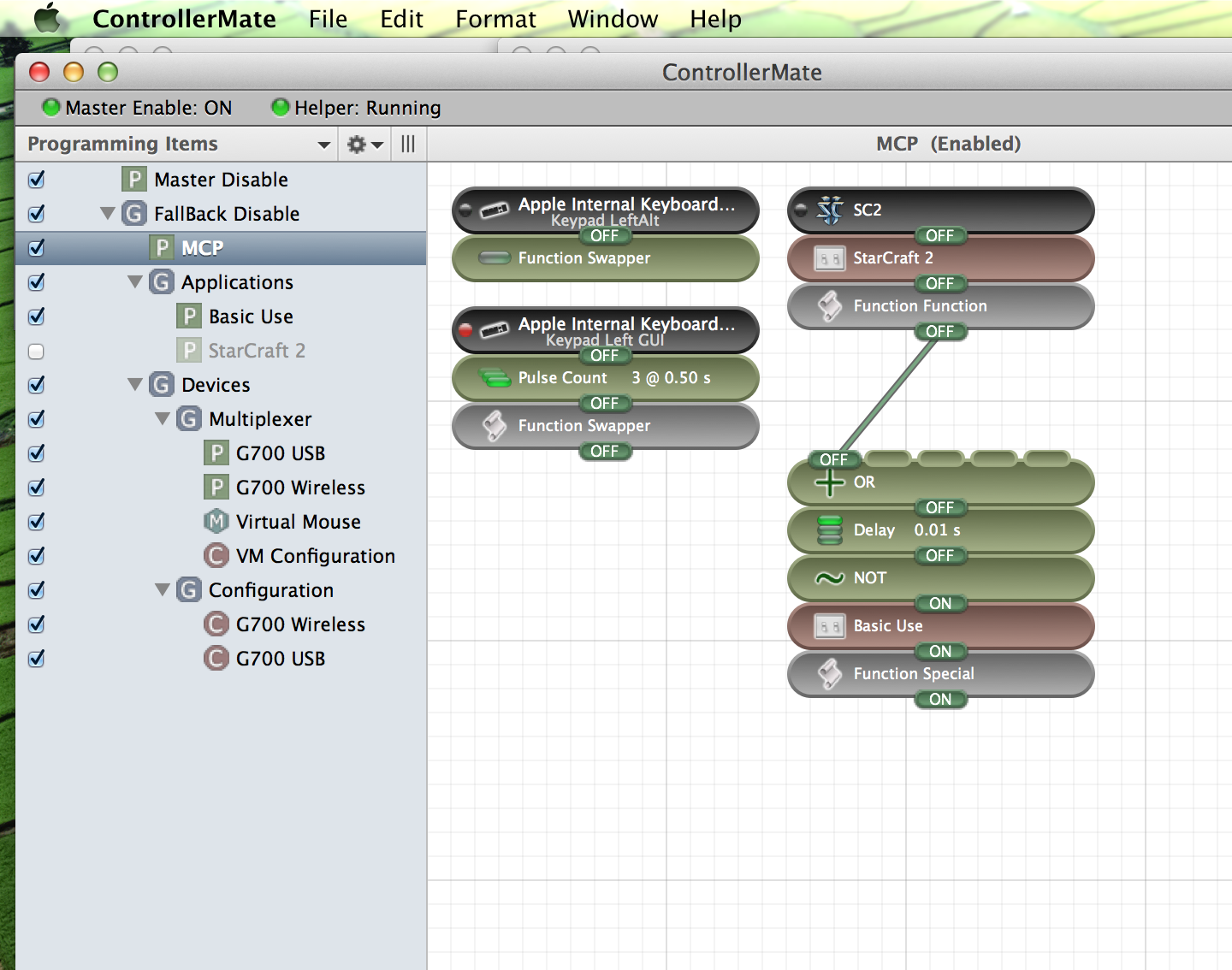

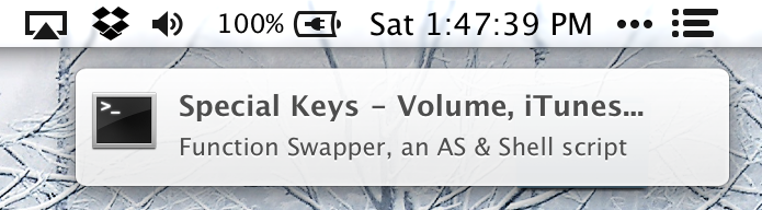

Added ControllerMate into the action
Using ControllerMate 4 (http://www.orderedbytes.com/controllermate/), I created a page for enabling mouse configuration for StarCraft 2 that swaps back when I tab out to Safari or Finder (anything not SC2). Using the above scripts as a starting place, I added AppleScript blocks that specifically enable or disable the Function Key behavior, as well as set up a fallback trigger.
My modified scripts uses a shell script to test the current value of the F-key row state, decides if it should swap the value and if it should display a message if changed. I'm displaying my message via Notification Center with the help of this trick: https://github.com/alloy/terminal-notifier All my Macs are 10.8, so it doesn't check for version number or that terminal-notifier.app is properly installed into ~/Applications/.
My Scripts
Function Swapper.applescript

My ControllerMate 4 configuration
