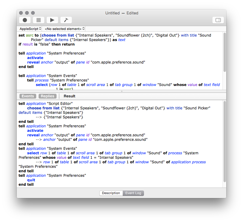

EDIT: I have tried some things:
Code:
get name of front window
when the Sound window is on the foreground gives:
Code:
--> missing value
If I use "window 1" to do the commands, it does seem to work (it can find the names of the output devices)
Works on Yosemite DP4-DP5. Not working on Yosemite DP6 with the aforementioned error.
Code:
set asrc to (choose from list {"Internal Speakers", "Soundflower (2ch)", "Digital Out"} with title "Sound Picker" default items {"Internal Speakers"}) as text
if result is "false" then return
tell application "System Preferences"
	activate
	reveal anchor "output" of pane id "com.apple.preference.sound"
end tell
tell application "System Events"
	tell process "System Preferences"
		select (row 1 of table 1 of scroll area 1 of tab group 1 of window "Sound" whose value of text field 1 is asrc)
	end tell
end tell
tell application "System Preferences" to quit
I have found that using window 1 instead of window "Sound" does the thing.
Maybe I'll change it to "Sound" again when the official release is out.
Thanks for the help anyway!
