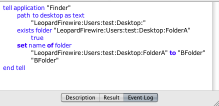

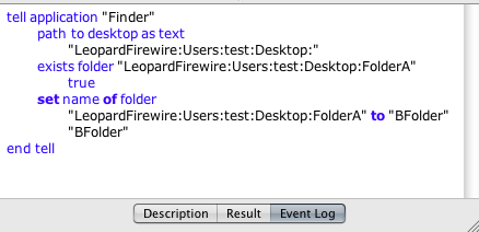

Post a screenshot of the Event Log when you run the script in the Script Editor.
YAY! Yours worked!!! Thanks!

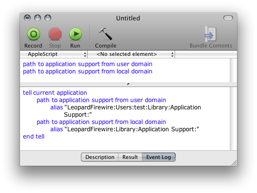

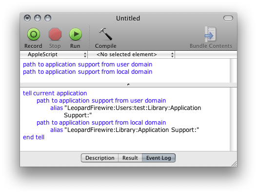

Alright, question for you kryten2. What if i want to reference the ApplicationSupport folder using "(path to desktop as text) & "FolderA""
Hey, does that "(path to desktop as text) apply when ever you are trying to connect to the desktop?
Yes
Depends on which Application Support folder you want to reference :
Code:
path to application support from user domain
path to application support from local domain
Info : https://developer.apple.com/library/mac/#documentation/applescript/conceptual/applescriptlangguide/reference/ASLR_cmds.html#//apple_ref/doc/uid/TP40000983-CH216-SW18
