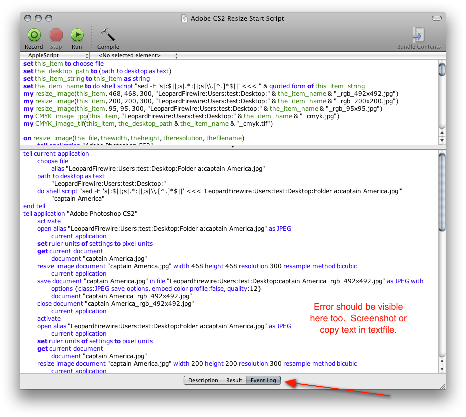

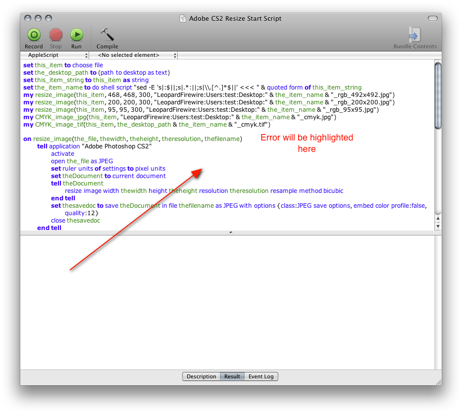

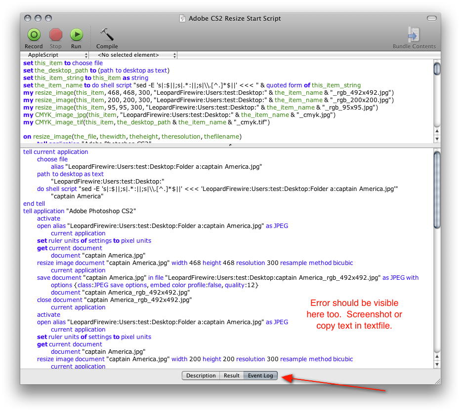

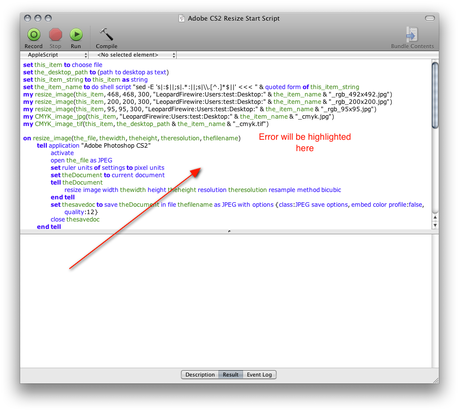

Strange shouldn't happen as the script worked for me. To debug this I'll need a couple of things.
1) Post the script you're using with the changes you've made(put it between the code tags!)
2) I'll attach another script for you to open in Script Editor and run after you made the necessary changes eg CS4 and paths. It's the same as the droplet with the exception that you have to choose a file manually. It will only process one file and you can comment out the second and third resize handlers and the cmyk handlers eg leave the first my resize_image as it is and put -- before the following four my statements. This will also speed things up. When the script errors it should highlight a section of the script where the error occured. Post a screenshot of the script window. Run the script again this time with the event log pane selected and post a screenshot of the event log. Or select all the text in the event log pane, put it in a text file and post that as attachment.

Code:
--My code
set [COLOR="Red"]the_item_name[/COLOR] to do shell script "sed -E 's|:$||;s|.*:||;s|\\.[^.]*$||' <<< " & quoted form of [COLOR="Blue"]this_item_string[/COLOR]
my resize_image(this_item, 468, 468, 300, "LeopardFirewire:Users:test:Desktop:" & [COLOR="red"]the_item_name[/COLOR] & "_rgb_492x492.jpg")
--Your code
set [COLOR="Red"]theItemName[/COLOR] to do shell script "sed -E 's|:$||;s|.*:||;s|\\.[^.]*$||' <<< " & quoted form of [COLOR="blue"]thisItemString[/COLOR]
my resize_image(thisItem, 468, 468, 300, "Macintosh HD:Users:tomfinnane:Desktop:" & [COLOR="blue"]thisItemString[/COLOR] & "_rgb.jpg")

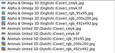

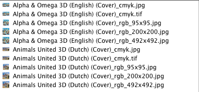

Hello again,
I've tried all that you told me to do and after massive headaches it finally works. So I would like to thank you for all your help in this matter you have been brilliant.
Thank you a thousand times
