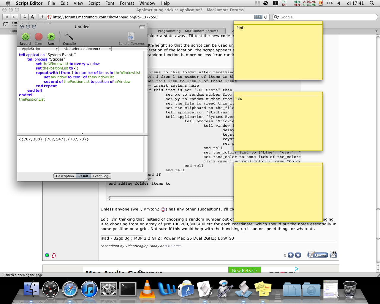

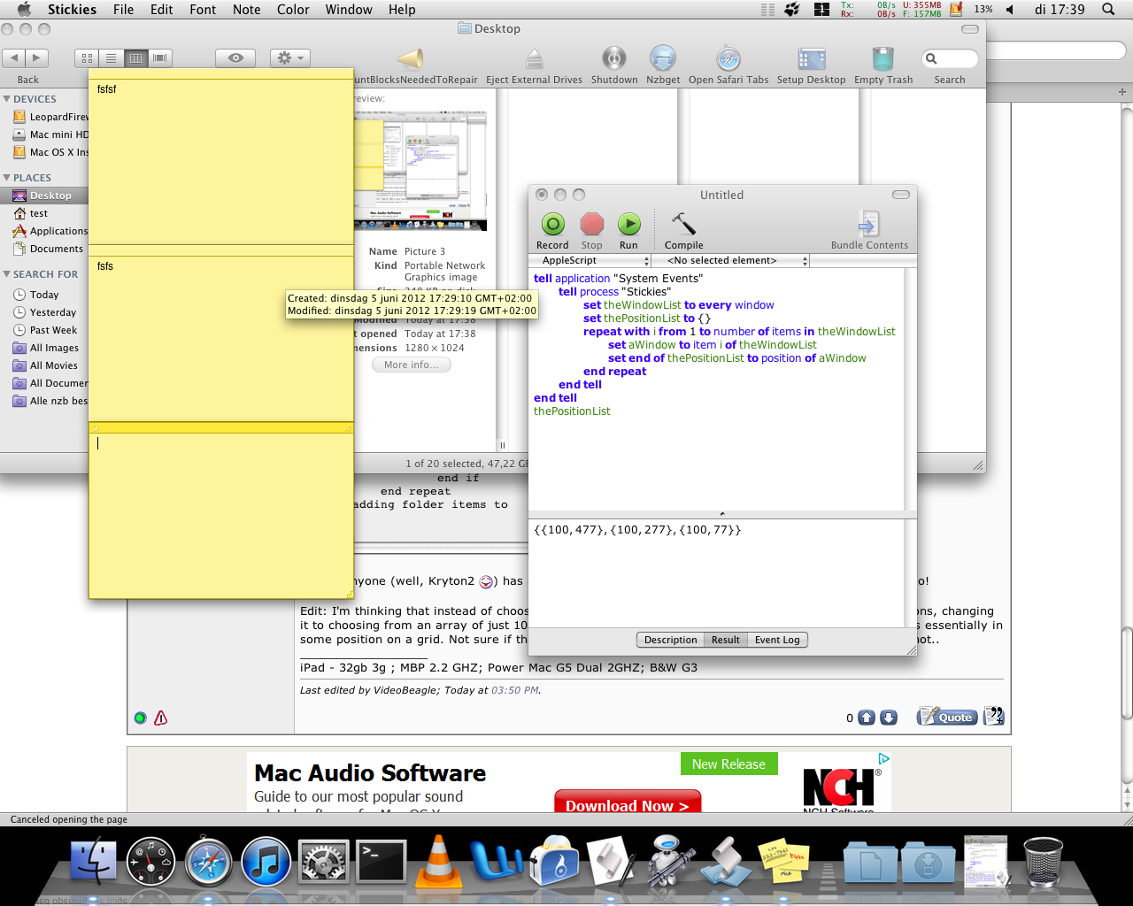

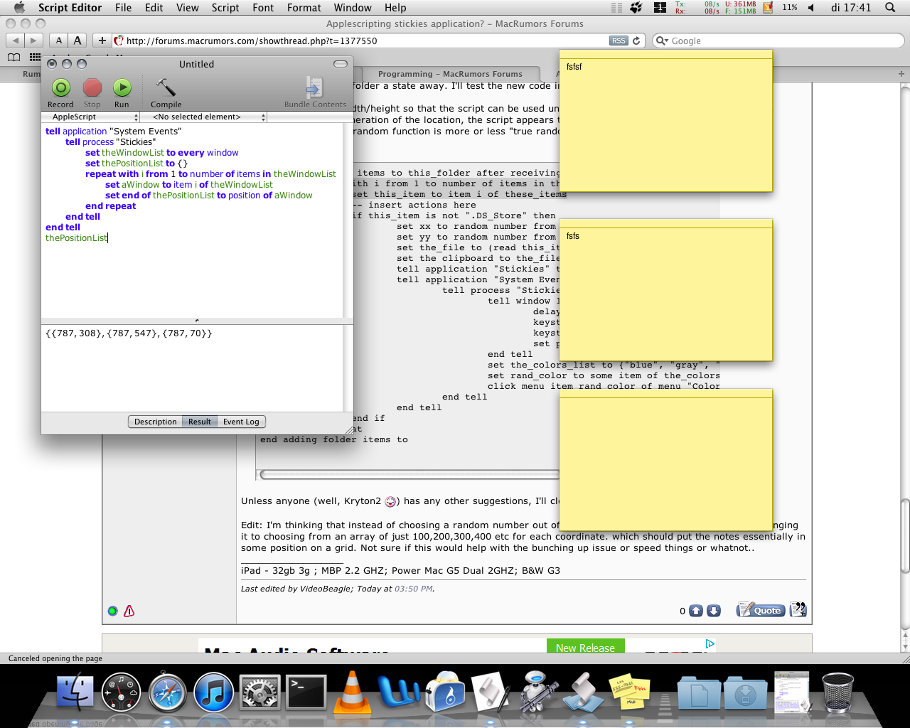

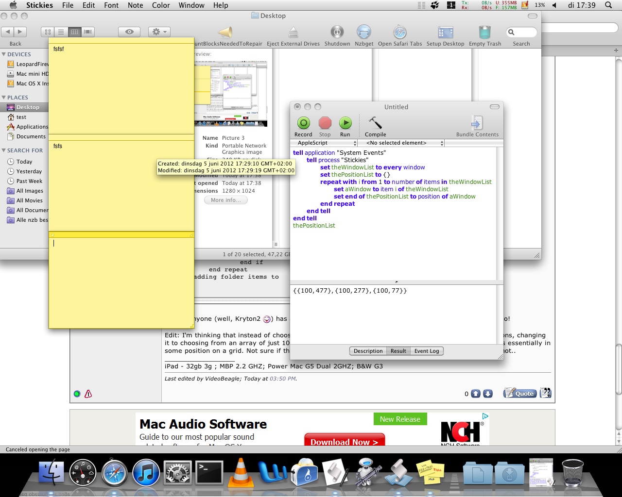

Perhaps you can do something with this :
Code:
tell application "System Events"
	tell process "Stickies"
		set theWindowList to every window
		set thePositionList to {}
		repeat with i from 1 to number of items in theWindowList
			set aWindow to item i of theWindowList
			set end of thePositionList to position of aWindow
		end repeat
	end tell
end tell
thePositionList
I'm not sure what that code does..(I can't test it til I get home).
It seems to just make an array of the positions of the notes?
Ultimately, for my use at least, I can't imagine there ever being more than 3 notes at a time, and usually not even that. This is really for items I suddenly think of when away that I must take care of when I get home, like "Oh! Must remember to pay the cable bill!" "Mom's Birthday! Call her!" rather than a lengthy to do list.
(Obviously, I'd like to make it robust enough for it to work for other folk's needs)
My eventual plan is to change the triggering mechanism, so that the notes come from like simplenote/notational velocity or something, but that's down the road.
