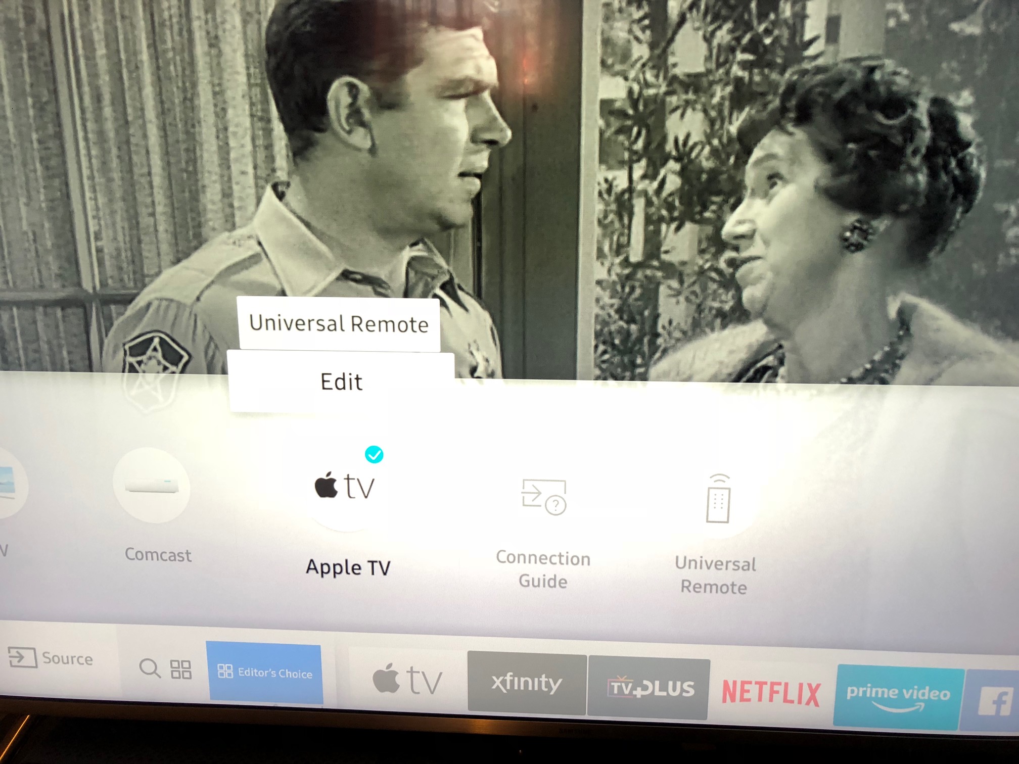

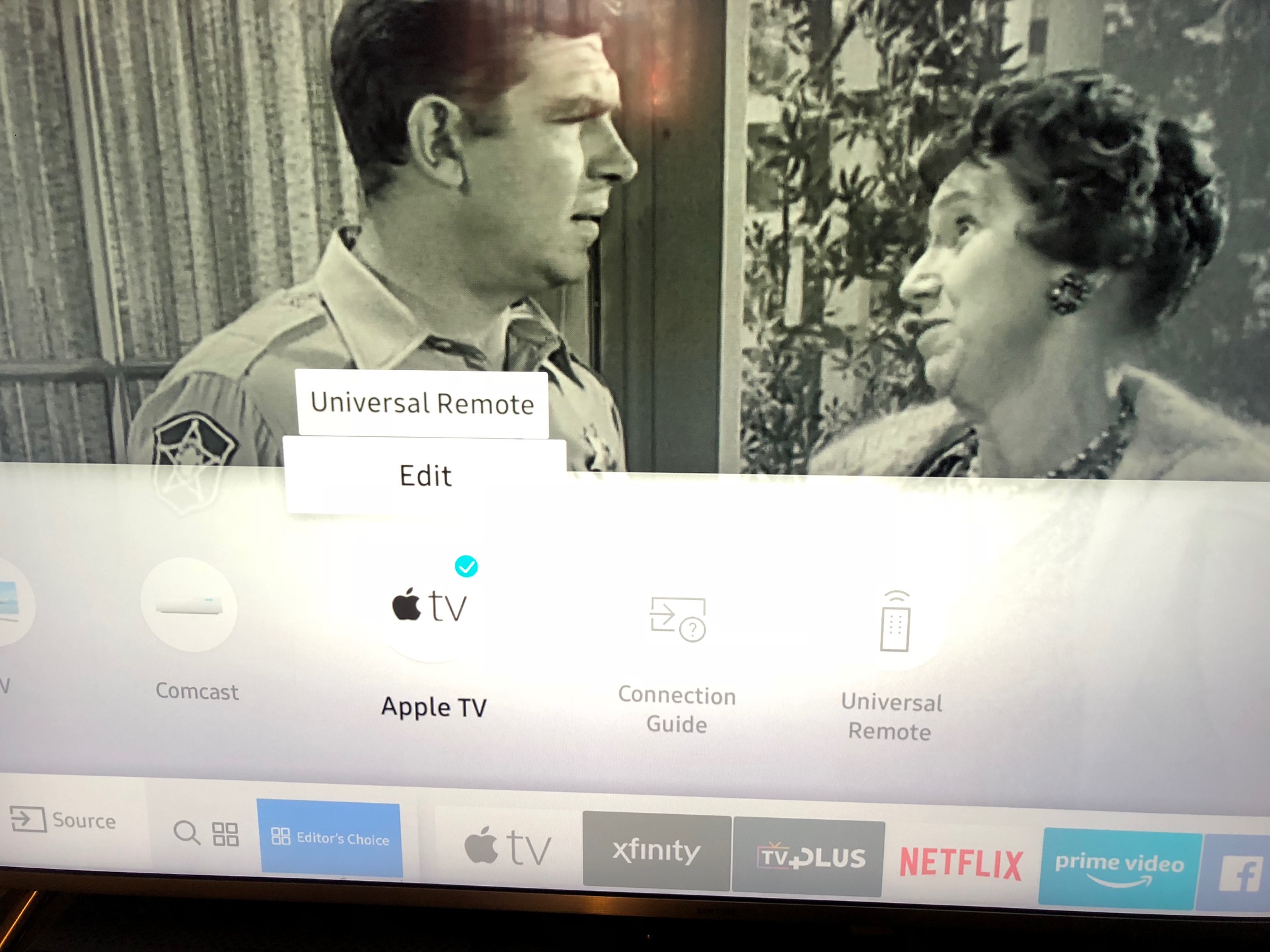

Go to sources and then select your Apple TV like this. If you have universal remote set up, it will say it is and you then remove it.
Hey TooDarkPark,
This is what I see when I go to sources and select AppleTV:
https://imgur.com/a/Zpqd3oM
No "Universal Remote" option is listed. As far as I can remember, I never set anything up specifically for the AppleTV remote or Samsung Remote control.
Thoughts? Thanks again for all of your time and help, it is greatly appreciated!
