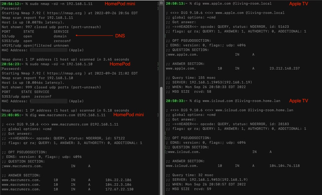

Interesting: On OS 16, Apple TV (4K Gen2) and HomePod mini are running a DNS server on port 53. HomePod does not do this, so perhaps this is related to Thread. In fact Thread uses IPV6, so the Apple discussion in your previous post about ATV acting as a router may be seeing this. These IPV6 addresses might be leaking or being offered on the standard wifi/eth network by mistake.

Adding a data point to the discussion, I have noticed that Apple TV (4K Gen2, tvOS 16) is acting as a fallback DNS server for Macbooks and possibly other devices. When my PiHole stopped responding I saw a LittleSnitch firewall alert asking if I want to allow mDNSResponder to connect to dns-tls port 853 of my ATV. So this is in addition to open DNS resolver running on port 53.
I see that Port 853 is open as well (both Apple TV and HomePod mini), so I wonder whether Thread/Matter uses 853. dif
What I noticed for port 53 at least, is that the DNS seems to checking with the the local network's DNS server. i'd be curious to see what happens when the up-stream local DNS is not available.
