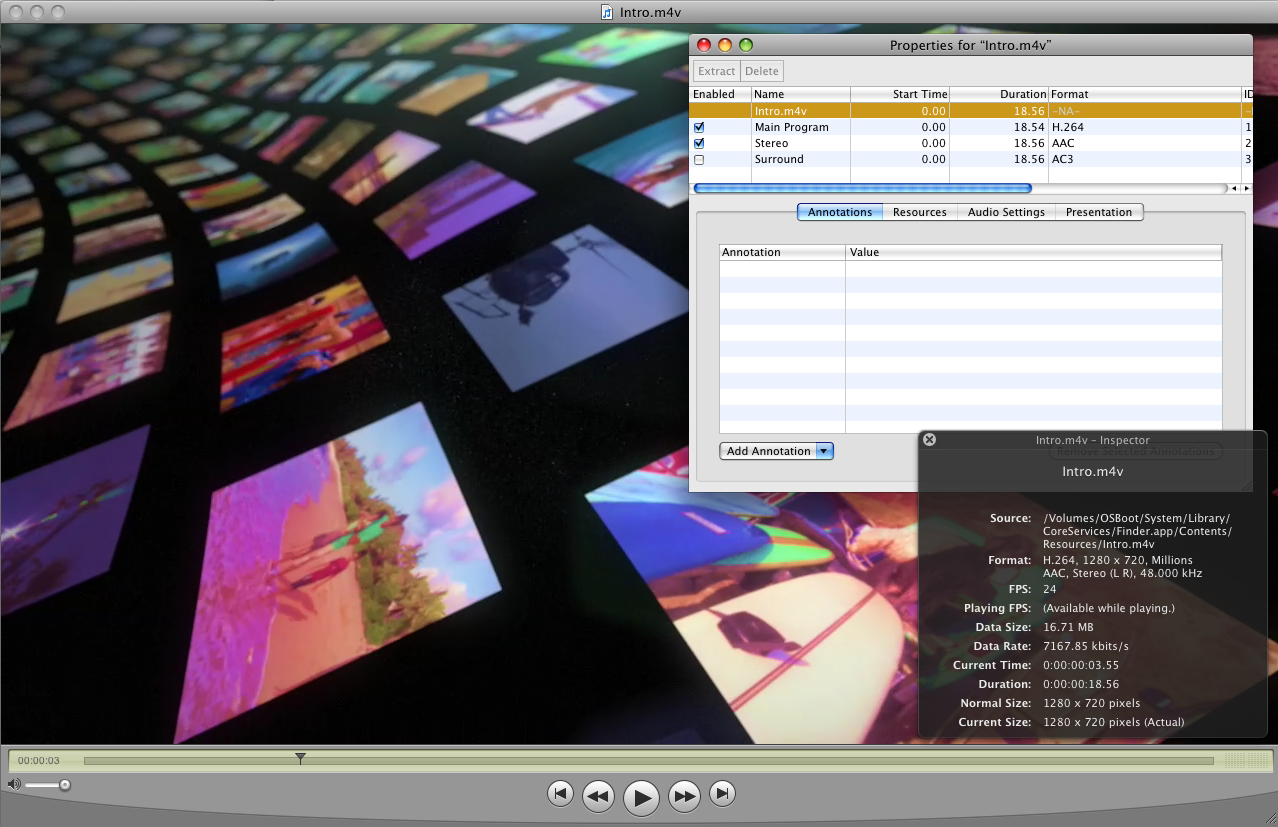

I hate to argue the point but the intro movie for the atv is done in aac and ac3. Reverse engineering that very movie is how hb first got ac3 passthru working in mp4.
Would love to see a screenshot of that intro movie in qt player showing the dts track. I wish you were right (DTS Passthru would be awesome) but I am afraid not on this one.

The first audio track must be AAC and the second audio track must be AC3 to get Dolby Digital (5.1).
As far as DTS, apple tv does support it and the startup video is encoded in DTS
No, the startup video (see attachment) has AAC as its first audio track and AC3 as its second audio track. You cannot sync or stream any file that has DTS audio because DTS cannot be put into an MP4 container, which is required by the Apple TV.
By "support" I mean only that it's capable of passing a DTS signal to an appropriately equipped receiver which can then do the decoding. Same as ac3. Maybe by "support" you mean that the content in the iTunes store is not DTS encoded, which I realize.
No, I mean the Apple TV will reject any file that has a DTS audio track.
