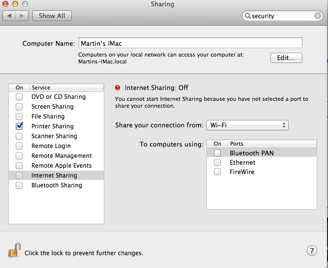

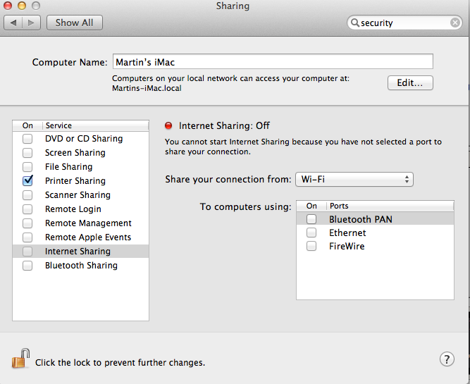

How do you get to the preference you are talking about? I only see this
