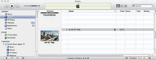

1+ year ago I downloaded 20-ish cool HD Quicktime clips, using iMovie I exported them in AppleTV format.
Import into iTunes, the file plays perfectly in iTunes:

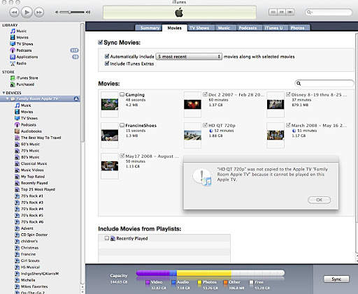

But I get this error when trying to sync it to the AppleTV:
(clickable)
If the file plays fine in iTunes, why can't it sync onto the AppleTV??

When I extract selected clips works fine, all 20 clips make a file that's 2.2GB in size, which plays fine in iTunes on my iMac but won't sync to the AppleTV, I tried 3 different times to re-encode the file thinking it was a encoding error, but now I'm leaning to a AppleTV file size limit....
