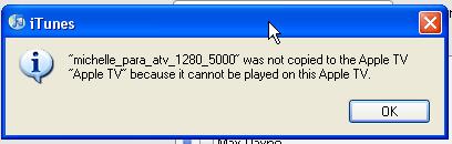

After reading some forums I decided to see if I can play 1280 x 720 video on my apple TV.
I created a file in HB using setting listed in some other forum.
I have also tried many different Bit rate settings, constant quality vs fixed. The only time it will play is if I move it to the default ATV format which is 960x something
The video shows up and plays fine in Itunes, but when I try to sync that video it says

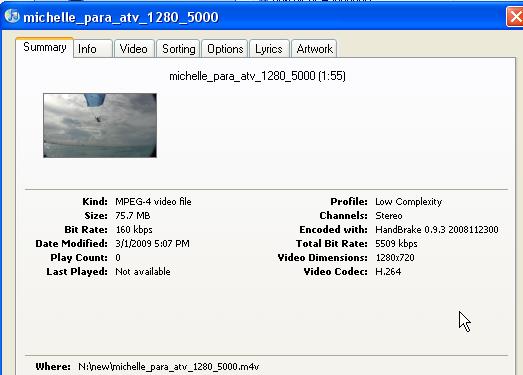

Here are the settings from Itunes.
Do some AppleTVs not play 720 content?
Can someone send me a short 720 file to see if it will play on my atv?

Your bitrate needs to be to below 5kbs and filesize no larger than 4GB.
People could actually read the tech specs.
Video formats supported
H.264 and protected H.264 (from iTunes Store): Up to 5 Mbps, Progressive Main Profile (CAVLC) with AAC-LC audio up to 160 Kbps (maximum resolution: 1280 by 720 pixels at 24 fps, 960 by 540 pixels at 30 fps) in .m4v, .mp4, and .mov file formats
iTunes Store purchased video: 320 by 240 pixels, 640 by 480 pixels, 720 by 480 pixels (anamorphic), or high-definition 720p
Any iTunes videos that are 720P are at 24fps.
24fps is the key.
24fps is the key.

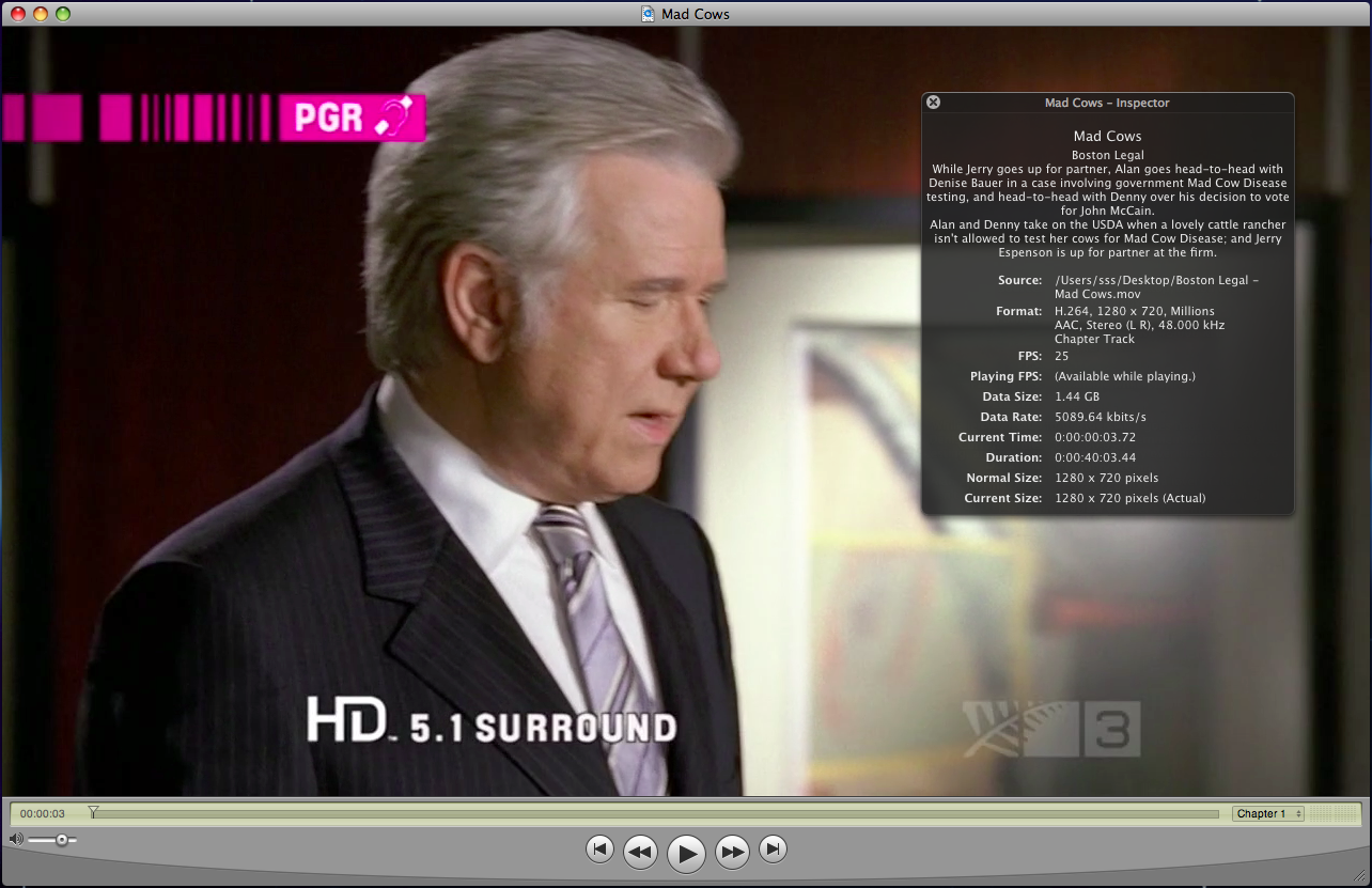

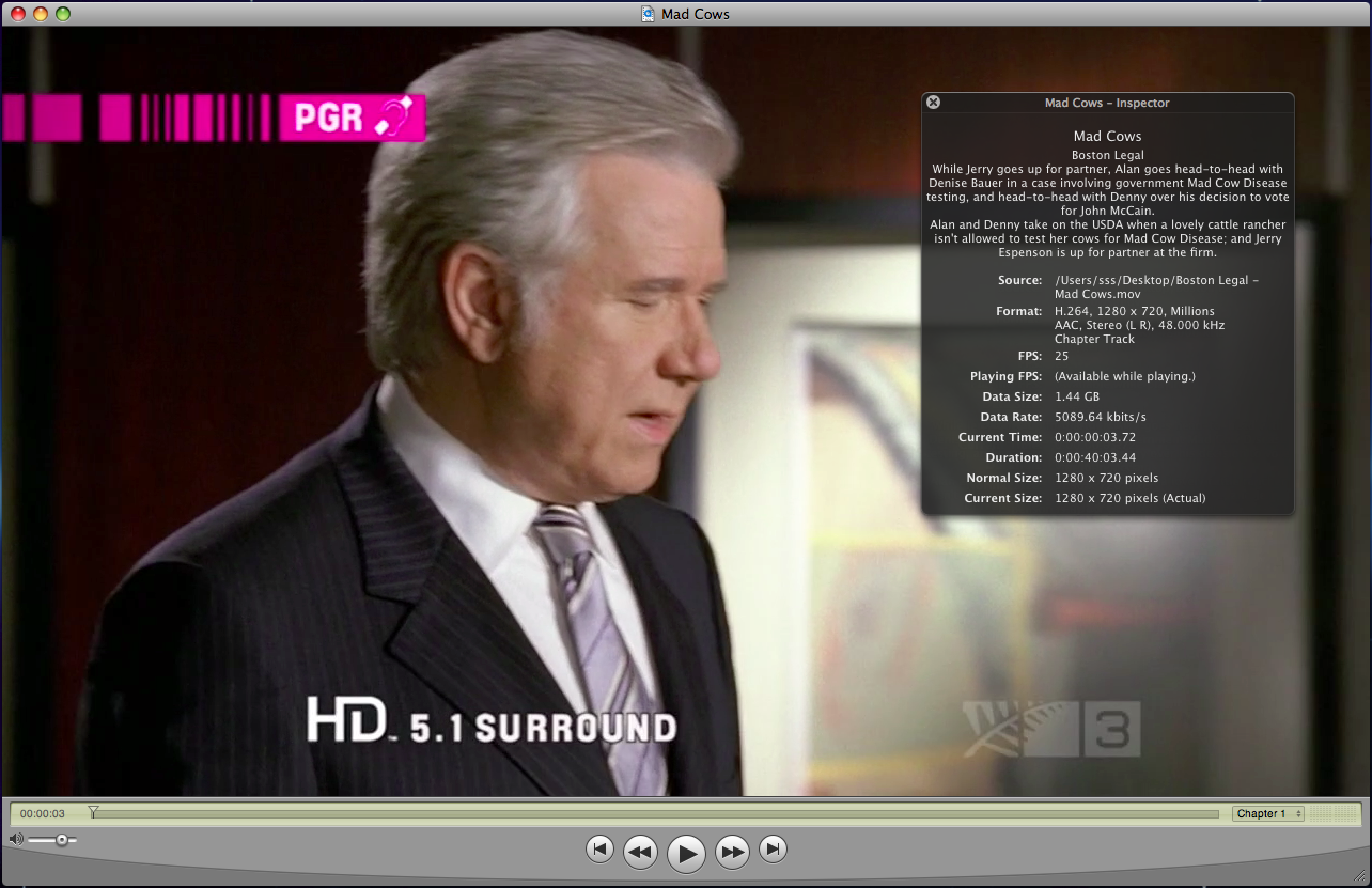

Actually, 25fps also works since all my encodes are from NZ broadcasts where HD broadcasts at 50Hz and I use QuickTime to encode them in HD for my AppleTV.
The attached screenshot was taken from a 1080i/50 broadcast which was converted to 720P. Note the bitrate is over 5MB but that includes audio so the actual video rate is less than 5MB. The FPS is 25. Just a pity that QuickTime doesn't preserve the 5.1 surround.
This plays perfectly on my ATV.
