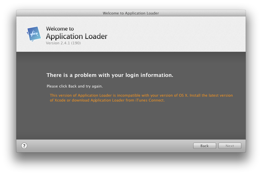

Anyone else having an issue using Application Loader in 10.7.3? 1.3 was working fine under 10.7.2. Updated to 10.7.3 and installed Xcode 4.2.1, which uses app loader 2.4.1. Now I get error reading password from keychain. Next page to sign in. I then see version of App Loader is incompatible with your version of OS X. I've tried deleting the keychain entry, re-installed Xcode. even tried applying the 10.7.3 Combo update. No luck.
Same issue here too. Please advise.

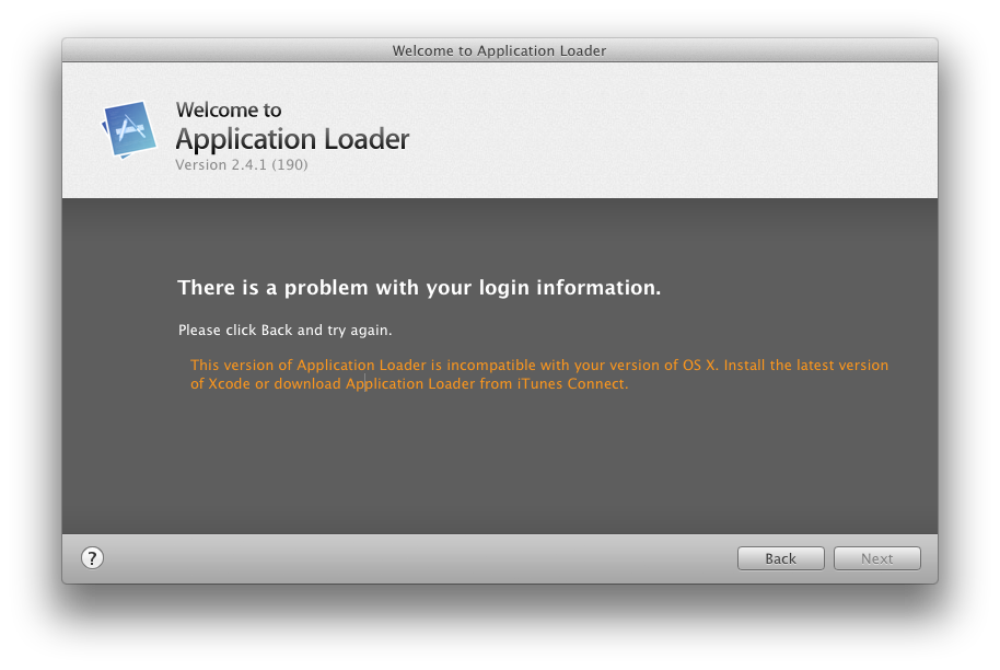

Screen shot attached. I get the same error within application loader - even after updating to the latest OS X Lion and Xcode versions, etc.
Your help will greatly appreciated.
Cheers!

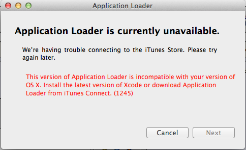

I got same error
I'm installed latest version and it works well 1week ago.
I can't overwrite install from AppStore because it is already installed.
The uploader of Xcode3 doesn't work as well.
attachment.php

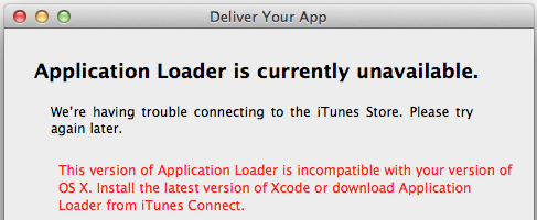

Having the same problem on 10.7.3 an my Air, even after totally uninstalling Developer tools, and reinstalling the latest version from schratch:
Annoying...

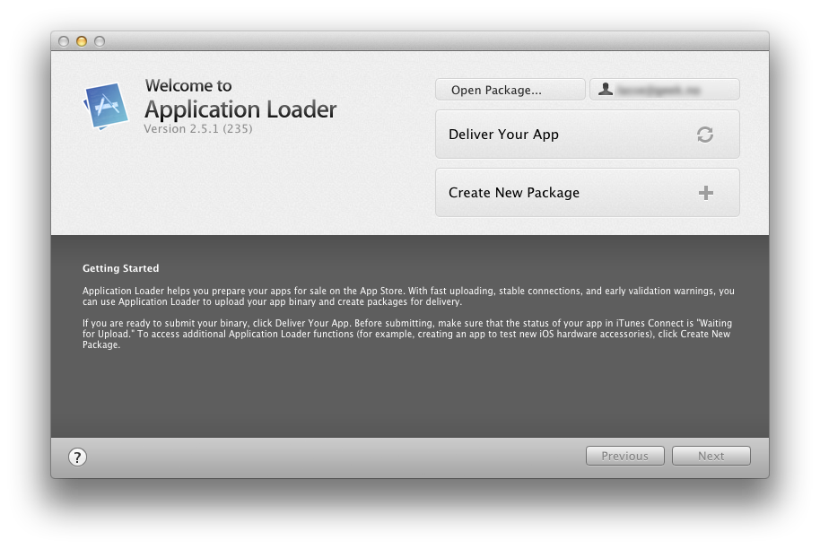

I like the new look, BTW:
Application Loader 2.5.1 didn't work
