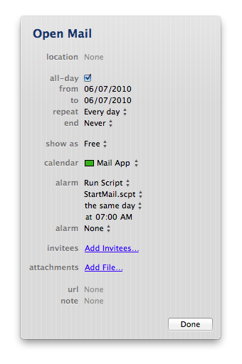

I would say save the two different scripts as indicated above...
StartMail.scpt =
Code:
tell application "Mail" to activate
and StopMail.scpt =
Code:
tell application "Mail" to quit
then set up a pair of repeating events in iCal to run them.
I tested, and you can even make a new Calendar (checkboxes on left) for this, then turn off the checkbox so it doesn't clutter up your calendar by showing the event every day, but it will still run.
For start:
Then create your opening event:

I tested this (with times adjusted to a couple minutes apart) and it works, without iCal running.
It's just too bad that iCal doesn't have a repeat option for "Every Weekday". It really should.
Well thanks Billy Boo Bob! It's exactly what I needed! And it works really well! :D
