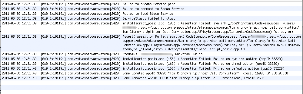

With the console open I found that nothing happens when trying to open the .app outside of the Steam software. With that software opened, connected to the internet, logged in to my Steam-account I get the attached log.
attachment.php
As I stated, I am no expert, I had trouble finding the console 🙄 Still I get the notion that this problem related to "connecting" to Steam which is strange since you are able to use the Steam software in offline-mode. (Nothing happens while trying to install or "Start game" offline using the Steam software.)
Can you tell me what the log means? Thanks!
