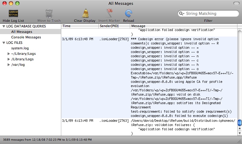

I attached an error log I found every time I try to use application loader.

I finally figured it out. I feel like such an idiot. I was using a development profile, and not a distribution profile. How I couldn't realize that is beyond me. But, everyone makes mistakes. Thanks for all of your help everyone.
