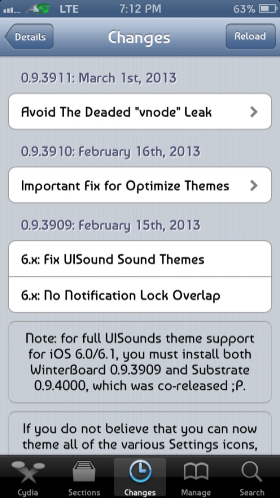

There was an update for ayecon tonight. Maybe if it addresses the issue?
Yes it's possible. I couldn't say for sure though. I don't use Winterboard or any themes. I'll see if I can find out if the update fixes the problem. I highly doubt it does though because other themes are causing it too so it's probably a winterboard/mobile substrate issue. But in the world of jailbreaking, you just never know! Haha

Uninstalled Winterboard and things are working properly again. Hope Saurik narrows down the WB or Substrate bug that causes this.

Nope...you are 100% correct. Like I said, it was better with a removal and re-install of Winterboard, but apps have continued to crash and not coming back until I re-spring. Facebook is the worst, but others as well.
Removing Winterboard from mobile substrate has stopped all app crashing.

Looks like there is an update to Winterboard that just came put that is supposed to fix this issue. ImageUploadedByTapatalk 21362194004.816980.jpg
