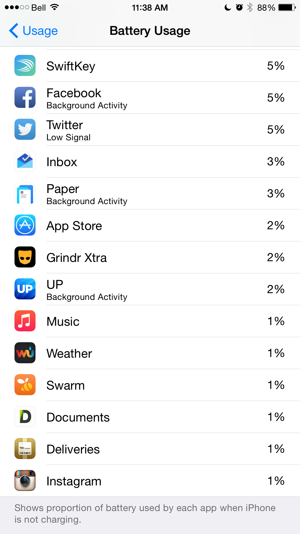

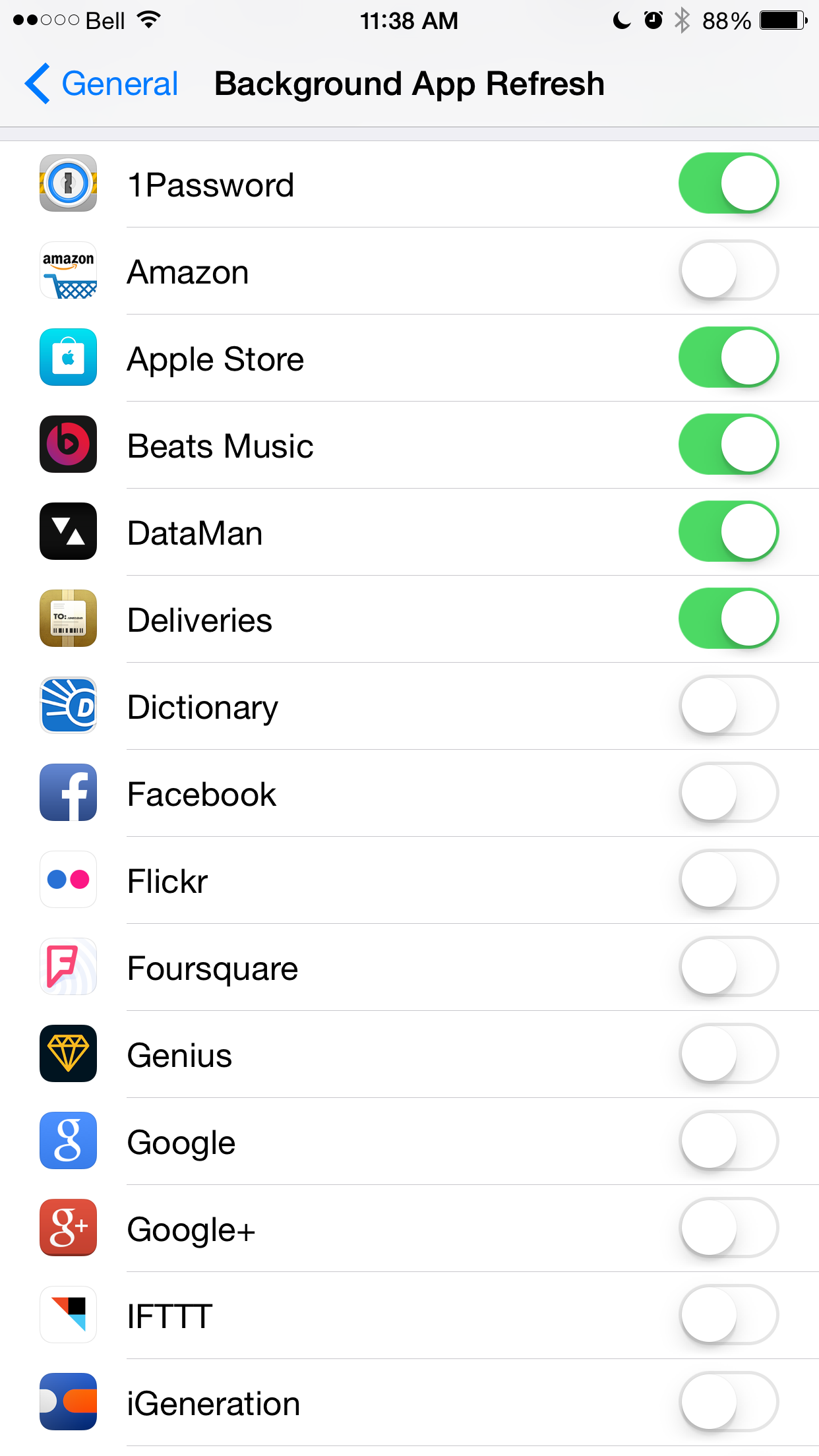

Hi,
I was wondering why some apps (Such Facebook, Paper and UP) are having "Background Activity" when the Background Refresh setting is either disabled for them or unavailable? For example, Background Refresh is disabled for Facebook but in the Battery Usage logs, Facebook shows up as having "Background Activity" as well as Paper and UP, who doesn't even have Background Refresh settings.
Can somebody clarify the different Background/Multitask modes of iOS (I don't understand well Apple's KB article on Background Refresh)?
Is anybody else having that "bug"?

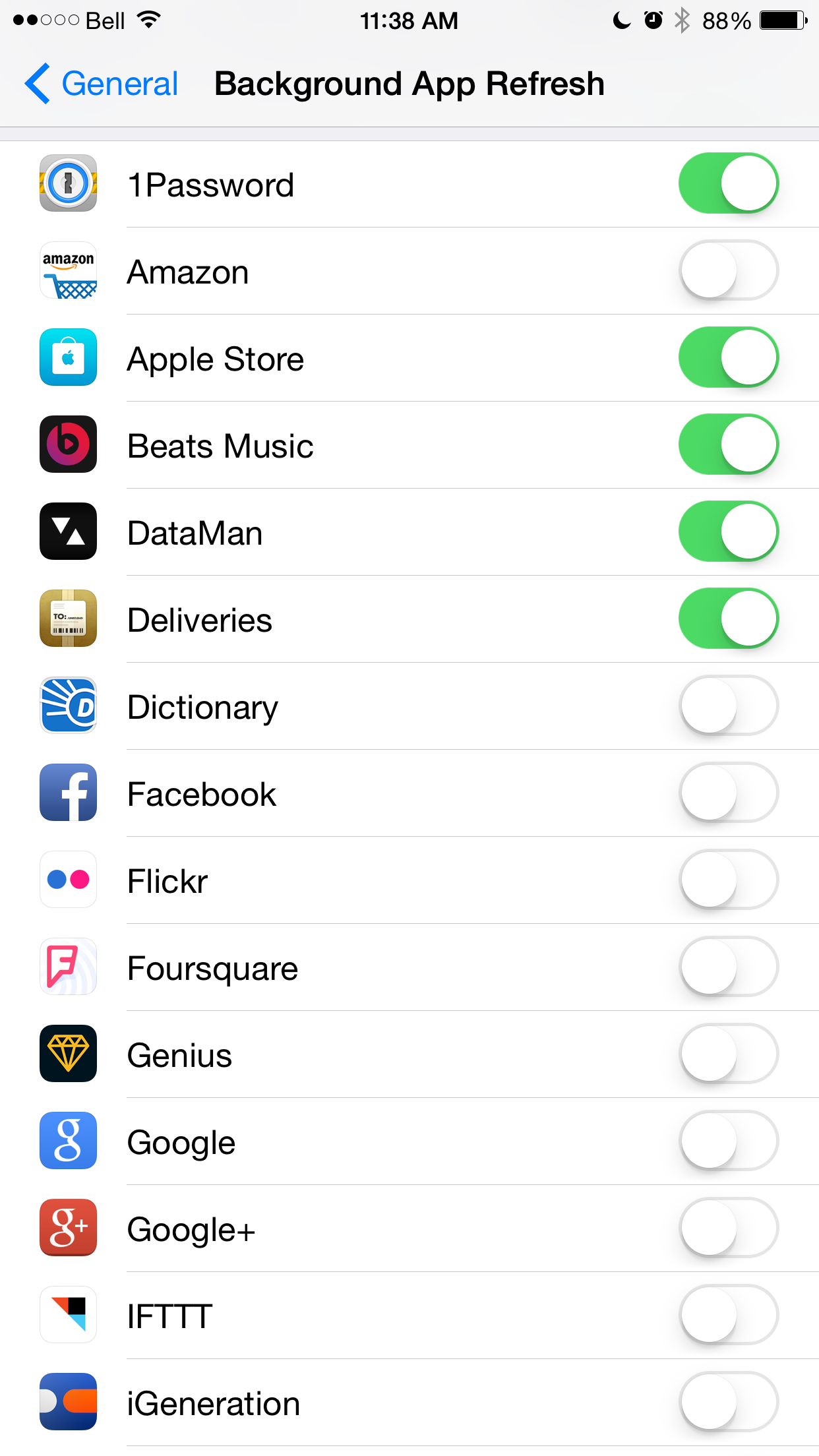

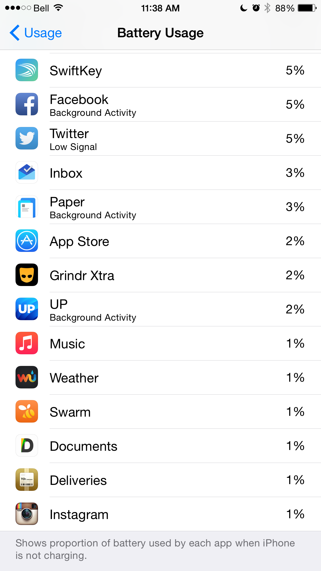

Hi,
View attachment 511730 View attachment 511731
As per apple support document
http://support.apple.com/en-gb/HT4211
'If you turn off Background App Refresh, some background activity might still occur.'
This could be the refresh of your local cache on closer of the app or such so for example if you post on fb and quit. It could take a few seconds for the app to pause causing a background usage figure to show because the task being processed at the time needs to complete before the suspend state kicks in.
I hope that explains it

There are many ways for an app to do things in the background. Background App Refresh only refers to the very specific case where the system will simply wake up the app periodically and let it do whatever it needs to do in the background.
Apps can be woken up due to changes in location, due to push notifications (including "silent" notifications that wake the app up but are not displayed to the user), and can continue to complete ongoing tasks in the background for some time after being closed. Background App Refresh only affects the cases where the system wakes up apps periodically for no other reason than to give them some time to load data in the background.
If you wanted to prevent apps from waking up at all, you'd have to disable their access to location services and notifications, and also be sure to manually swipe them out of the app switcher whenever you're done with them. Not worth it. 95% of apps behave just fine and have minimal battery impact from their occasional background activities.

There are several activity allowed to run in background. The main issue is usually with VOIP app.
The system allowed voip app keep running in background.
The definition of background app refresh is different than background activity.
Background app refresh= system wake the app periodically to fetch data
Background activity = the app never terminated
Now. The tricky part is FB app. They used to be running in background due to previously their messenger is built in to the main app. Messenger can make and receive call. Thus categorize as voip.
Now they separate the main and chat app. I'm not sure if they still allowed running in background.
The first few iteration still drain my battery. Now the battery seems fine even when they are not removed
