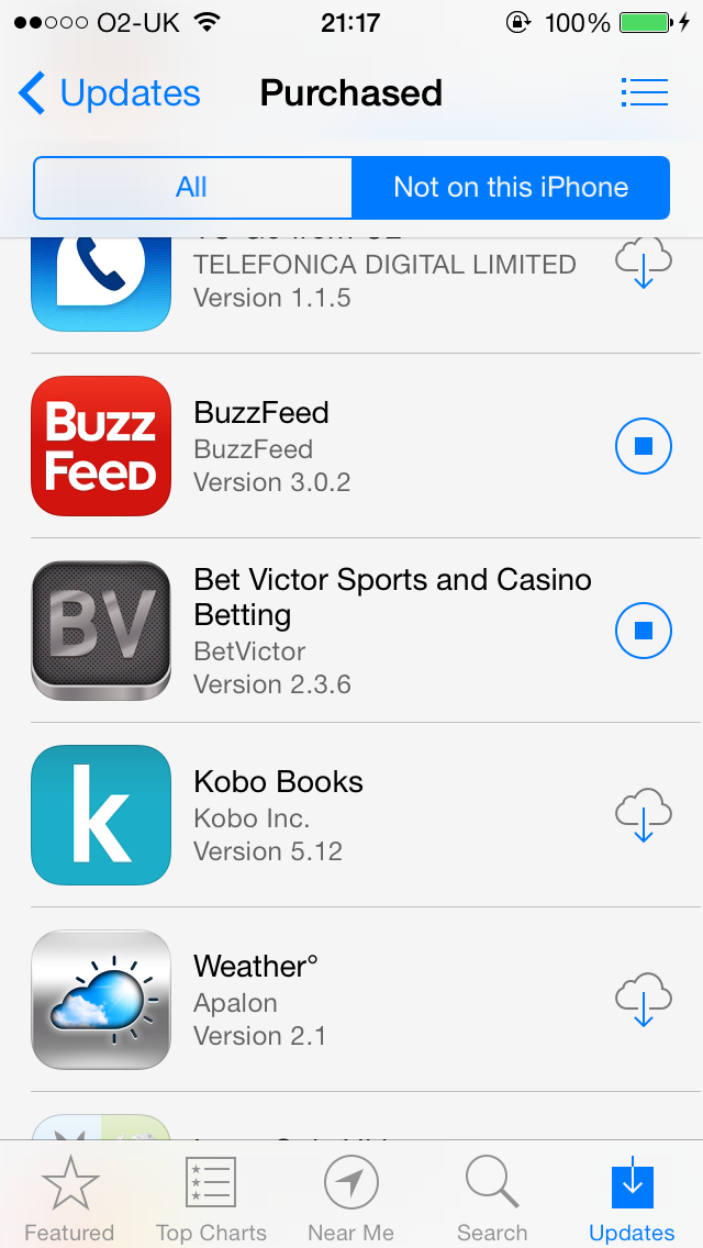

I had a similar problem, except when I go to redownload the apps, it wont let me as they appear as if they are already downloading, any ideas? I've tried deleting all my apps from iTunes, re-syncing but the problem persists

App stuck in waiting
Try these simple steps:
Just press all the "pause" (blue square) button beside apps in the appstore.
Then you can try updating apps one at a time
*App usually stalls when your internet connection is not strong and stable enough to accommodate large file size updates.
