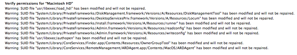

Disk Utility won't let me run repair permissions or verify disc. When I ran verify permissions, this is what I got.

Any ideas? I would REALLY like to avoid having to do a clean install, but I'm afraid I might have to.

Disk Utility should let you repair the permissions but it's normal for it to not allow you to repair the drive. You can't repair the drive you've booted from. Instead, you must boot from the OSX discs and use that version of Disk Utility to repair the drive (if necessary). Don't worry about the permission errors for now. 🙂
Ok, thanks, that's good to know. But I can't even repair permissions - it just goes forever, says there's less than one minute left, but I end up quitting the process after 10 minutes have gone by. The fans go like crazy. Do you think I should just let it go, and if so, for how long?
Or - maybe not being able to repair permissions is a sign I should boot from the disc and repair the disk? 😕
Repair the disk first of all. It could be an underlying problem that is causing all of this. Even if it's not, a slow or unresponsive Disk Utility is the least of your worries. Hopefully it's just a matter of running the disk repair a couple of times and having everything back to normal. 🙂
