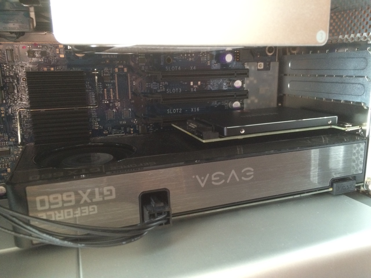

As the title says, I have a Mac Pro 3,1. Here is my dilemma:
Currently running Samsung 850 Pro on Apricorn Solo x1 card (runs great, really like it).
I want to add a second Samsung 850 Pro and setup with raid 0, so I figure this is a good time to get a faster PCIe card for the drives.
I need to use the second PCIe slot because that is 2.0. The higher ups are 1.0.
The Velocity Duo x2 will cover the top fan in the GTX660.
Can I go with a Solo x2 and just use a cable off it for the 2nd SSD?

I'm running two Duo x2s in my Mac Pro 5,1 with a GTX 780, and I do not have any cooling issues. One of them is in slot 2, just above the card. I must mention though, that my card is a 3 fan Gigabyte.
Lou

Do you know if the speed would be the same with two SSDs on a solo x2 (cable off the end method) as compared to a duo x2?
Just worried about covering the only fan on my graphics card. However if you are covering all 3 and still running cool, that is good to know.

I put mine in slot 3 because it covered the fan on my HD5770. One of the things I am going to look for in a GPU replacement is one where the fan is placed past the end of the Vel Duo. May even an HD5870.

And just to add, if the OP is concerned about GPU temps. He can always mount the GPU in slot 2, leave slot 3 open and mount the Duo in slot 1. And yes, my Duo covers all three fans in my GTX 780.

Wow, I feel like a complete moron. It didn't even hit me to put the GPU in slot 2 and the duo in slot 1.
Ok, last thing I hope - Is there any downside to having the GPU in slot 2? I know they are both 2.0 spec so I would think not.

When I had my 2008 3,1 Mac Pro, there was a time I place my Nvidia 680 gtx on slot 2 as I had a GT120 on slot 1. Everything ran fine with no problems.
I could be wrong (not unusual for me) but the design of fans draw air instead of pushing at the fan openings. It doesn't require that much space and since its a dual fan configuration it probably makes very little difference. From looking at your photo, I believe there's enough space for adequate draw to take place.
