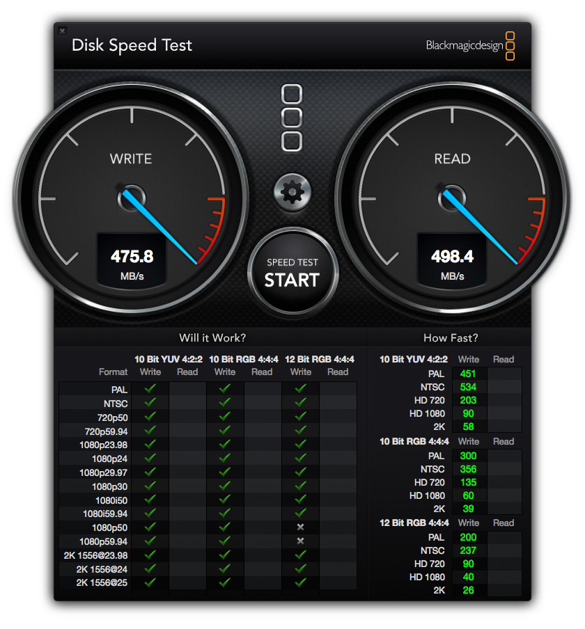

IMO, you should able to get better speed. I am with the Tempo SSD, so don't know if there is anything can do with the velocity x2. Anyway, for your info, my 840 Evo 1T able to perform quite close to what you expect.

Have to agree. I'm using a Velocity x2 anyway and I get similar results with the 840 Evo 1TB. When running the Black Magic DST for a while the read/write speed will drop a bit but it shouldn't be that much.

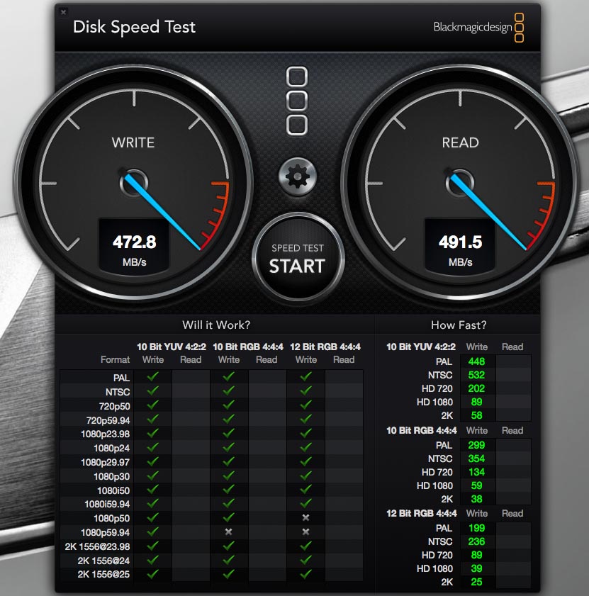

My results with the Solo x2 and and EVO 500GB.
