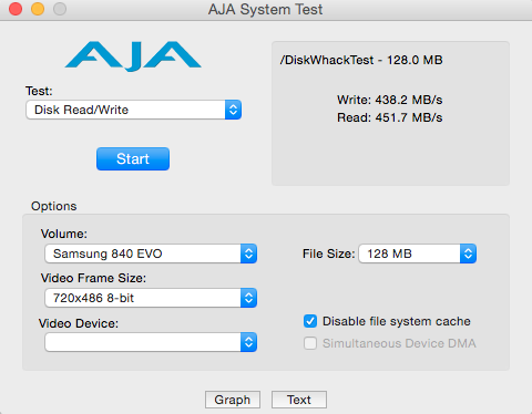

Solo X2 with 250GB Samsung EVO. We´re talking about 40s from start to desktop. First I thought something was wrong with my 240GB OWC, so I purchased the EVO, which didn´t improve boottime.
The machine boots faster when the SSD is mounted in the backplane.
Except for the boottime, the Solo performs as expected.
Thanks for your feedback and to see your speed numbers!

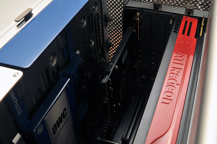

Does the duo extend to neighbour PCIe slot? I.e. Eat up two slots or just the one? If it does take two, is there any downside to running two solo's? That would still work in RAID0 right? Maybe two solos more expensive than one duo?!
Pictures says more than words - sometimes 🙂
