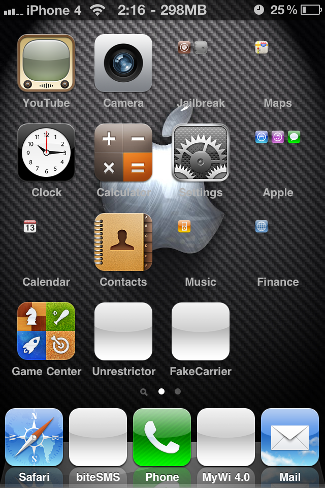

I had my iphone 4 jailbroke on 4.0 with jailbreakme. i decided to take the plunge today and update to 4.1 and use greenpois0n to re-jailbreak. i thought i would be smart and use aptbackup to back up all my cydia apps.
well the update to 4.1 went well, and the jailbreak with greenpois0n ran just as it was made to. when i was done all my apps from the app store were there and my phone was once again jailbroken. then i ran aptback up, and thats where it went south.
1) it did put all my jailbroken apps back on the phone, but the icons are white without the pictures. what i mean is insted of the bitesms pink icon i have a white blank icon. and that is how it is for all my jailbroken apps. i guess i am going to have to delete them all and reistall them if they have an icon.
2)when aptbackup was done all of my apps from the appstore (apple) are gone, just gone, not on the phone. so here in a second i am going to try to plug it in to itunes to get them back, i hope all my data is still there.
3)under 3gunrestrictor the facetime option is gone.
WTF i am so pissed right now. i will update when i get done on itunes.
**update.**
I went on to itunes and put all my apps back on. then while it was putting them back in to folders, i realized that infinifolders was not installed. so i went on to cydia downloaded it. well the phone resprung, and when it was done all my stuff was back the way it was before aptback up screwed it up. except some of the data from inside the apps is gone. so at this point i dont know whats going on. (by the way i tried restarting the phone before but it didnt fix the problem)

have you tried disabling the theme and running no theme and seeing if the icons come back?
no i did not have a full theme running, just a few tweeks. i will give that a shot here when itunes is finished putting all my ***** back on my phone. ill let you know how it goes.

I realize this thread is a bit dated but as I had a very similar experience to the OP today and was able to get through it successfully, I thought I'd offer my $0.02 in case someone else has a similar problem.
I too was updating from iOS 4.01 jailbroken using Jailbreakme.com as I wanted to be able to use Facetime with another user on the new Mac beta so I ran Aptbackup, upgraded to 4.1, backed up my phone and then ran limera1n, all with no issues. Afterwards, following the directions provided on Aptbackup (and limited at that), I choose the restore option in the app and upon completion, had the exact same result as the OP.
I decided to try to restore from backup via iTunes but midway through the sync, I unlocked the device to check something and found that it killed the backup restore and left it only partially complete (same as OP). At this point, since it looked like the restore from backup was working and my JB was being maintained, I reran the restore from backup, let it run to completion without interruption and voila, fully restored JP iPhone running iOS 4.1 and now able to Facetime to the Mac application.
I'm not sure if this is how the process was supposed to play out as Aptbackup provides little info beyond 'hit this button to backup and hit this button afterward to restore' but end result works just fine, though my biteSMS icon is still white, 😕.
