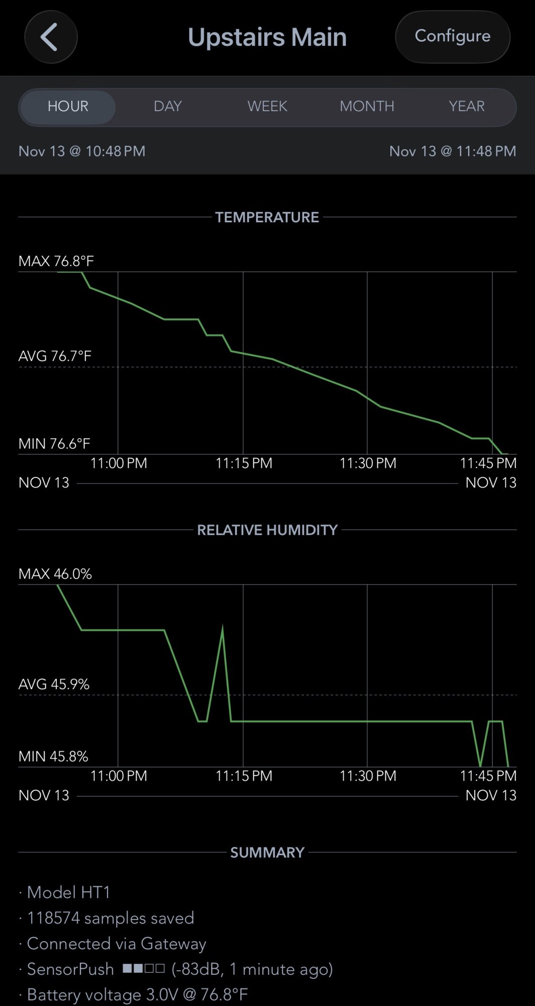

This sensor is interesting because it could replace what I use 2 sensors for now - SensorPush for temperature, and Hue motion sensor.
Graphing temp data from that SensorPush sensor helped me negotiate an in-warranty replacement of my HVAC condenser. On the bad, replacing its CR 2477 battery is SUCH a pain. I need to use an eyeglass repair kit screwdriver. But it seems to be a very accurate temp sensor.
