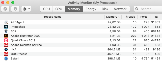

Strange things happen on my Mac Pro (2013, Catalina). ARD takes up all the free memory.
(see attached pic). It slows down a lot my old good trash can.
I can't just uninstall ARD because I need it.
Is it fixable?

How much memory do you have installed?
What does the "Memory Pressure" graph show, at the bottom of your Activity Monitor/Memory tab?
