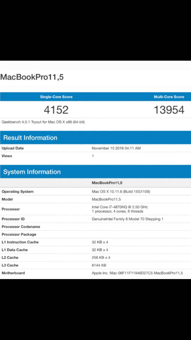

My 2015 15" MBP 2.5 repeatedly (15 times in a row) gets over 13800-13900+ Geekbench score Multi core.
Looking at the score chart, it's running as if it's a 2.8. Are all CPU's created equal ? regardless of what MHZ stamped on the chip? Back when I was building PC's (overclocking) chips varied chip by chip on how high they could be oc'ed while being stable.

I'm at work so can't run it now, but I'll do it again tonight when I get home.
Here's a screen shot.
