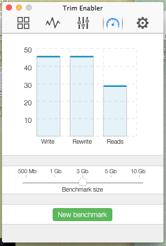

So i just got my 15ft FW 800 cable in the mail... it was like $20 shipped. from just looking at it, the quality looks fine to me. I did some speed tests, and it seems slow to me, what do you guys think? Would i benefit from getting one of those high quality $60 cables?? The higher end ones seem to look different them normal ones. they have little plastic capsules on each end. I have post a pic below of the the higher end ones have the the normal ones dont, what is this thing?

Here are my speeds when i tested with my cheap 15ft cable...

That's weird, i am getting under 50MB and your getting almost 20 more than me... what program are you using to test your speeds. I would like to do a test the same way you do to compare evenly.

I tried a big file and watched in activity monitor. The issue is that it really fluctuates a lot. Seems to go all over. Spike from 45 then 3 sec later hit 55, then keep spiking up and down.
