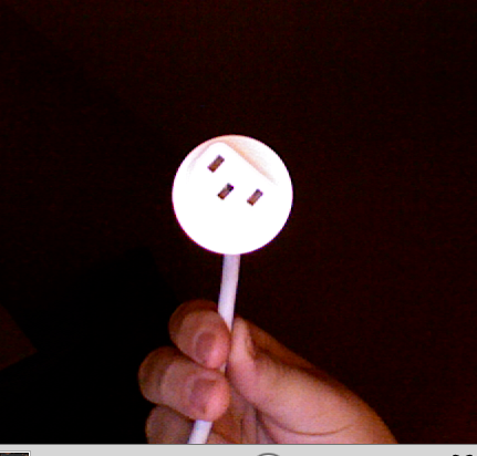

My ACD and my Powermac G5 appear to have the same exact cord. Are these interchangeable?
I ask because one has a 7 on it and the other has a 4, so while they look the same, maybe they aren't?
I am still grappling with my random shutdown issue, and I wondered if I could switch the cords to see if it's faulty.

They are different part numbers.
There should be markings printed on the cables (white on off-white, so they can be hard to read). If the AWG numbers are the same, it should be safe enough to interchange the cords.
no... I am realizing maybe these are different across the pond? I am in the states... It is similar to that but the flat part is square.
If they aren't the same thing, it seems a bit sketchy that they would give you two cords that appear the same but aren't. Anyway, they do have different numbers on them. I guess I'll leave them alone for now. Thanks guys!
If the ends look similar to the ones above apart from colour then they should be interchangeable. Its only a lead with a fuse in the plug rated for whatever its being used. They'll probably have the same rating fuses anyway.

In europe, theses two power cords are interchangeable without ANY PROBLEM. You can even put in others that we can find in the PC world, theses are "standard" power cables with a bit of specific design and color, but the specs are strictly identical
