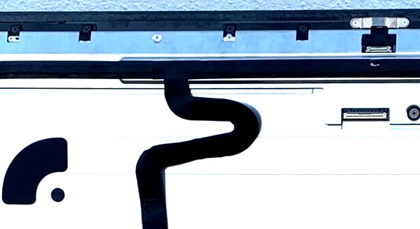

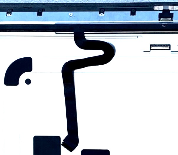

Yeah it’s doable, only real difference is the backlight cable being at an angle on the 2019 LCD compared to straight on the 2017. But you can just angle it into place and forcefully push the screen back for it to be okay, or just swap the backlight cable over if you wish.
Cases are identical

The backlight cable of a 5K iMac screen (all years) is fixed to the screen electronics. There is no detaching it.
FWIW the iMac Pro backlight cable (fixed) and eDP cable (removable) are in totally different positions.

The backlight cable is that black cable, which is stuck down with adhesive to the assembly, you can easily pry it off. Then it is simply connected in both bottom corners which can be lifted up after removing small bits of tape.
