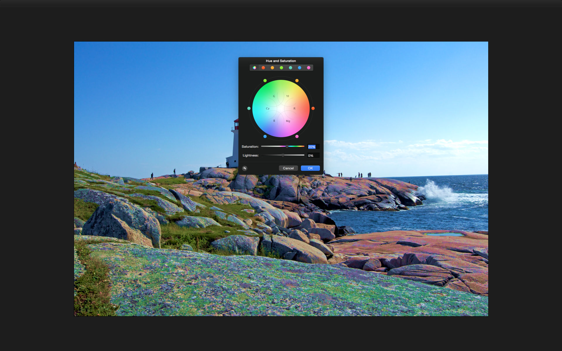

Here is what I'm talking about after a modest 20% boost in saturation.
OK, I get what you're saying. Ya, it really goes nuts. I trying saving a file as a TIFF and editing that, does the same thing. Weird. I tried some old PSDs, and it seems to be just the way Pixelmator works.
Raws don't respond that way. It looks like you opened an embedded thumbnail or something of that sort. I don't think it works as intended because it can't decode what you expect it to decode. Either way you're not getting adjustments that you would think of as raw adjustments, meaning adjustments made to an unclamped image in something near a gamma 1.0 space. Basically you don't have anything equivalent to a raw processor there, which is why you're having trouble. There are options. Capture One, Darktable, Lightroom, RawTherapee, etc.

Again, I'm more than happy with how Lightroom handles the raw file, or ACR, or Capture NX2. It's not a case where I can't achieve my desired result in anything but NX2, it's just Pixelmator that I noticed this odd handling of the colors. I think my question was answered as to why the results were as they were, and it was because Pixelmator isn't a raw processing program at it's heart.
You can see my slider setting in the pic above, and it's at 20%. As you say a value of 20% in Pixelmator may not mean the same thing as 20% in Lightroom as it's just an arbitrary number, but never the less the colors shift unnaturally very quickly in Pixelmator. I have found you have about a 1-5% window in Pixelmator's saturation adjustment before the colors go wonky. This happens much farther up the slider in Lightroom which gives you much more flexibility. This isn't necessarily a knock on Pixelmator if it doesn't proport itself to be a raw file editing tool. Just an observation for someone who might be wondering if Pixelmator could serve as a "one stop" photo editing tool.
As far as not knowing what I am doing with Apple's raw converter, that may be, but I would like to know what you think I'm doing wrong specifically in the example above? It seems to me a boost in saturation should boost the color intensity, not throw the hue off drastically at the very start of the adjustment slider.
Other than opening a RAW file in Pixelmator, you're not doing anything wrong. The program seems to be very aggressive with the Saturation adjustment.
As I have mentioned in my first post (and others have, too), you're mistaking Pixelmator, an image editing app, for a RAW converter.
