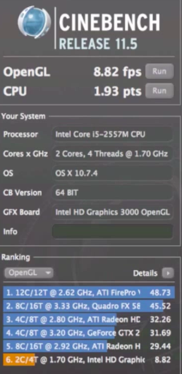

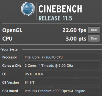

My jump from Sandybridge to Ivybridge, benchmark results.
