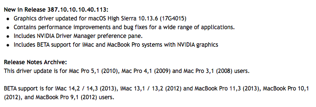

^^^^My Gosh - You Guys still keep on insisting when it plainly says on the Nvidia web site that it is NOT a BETA for the cMP 3,1, 4,1 and 5,1.pat.gif
Please read and comprehend what the above from Nvidia's web site says!!!!!!!!!!
However, I have no argument with the level of support we get. Nvidia's support for Mac drivers is far far less than for windoz drivers, which is perfectly understandable given the animosity between Apple and Nvidia and the relatively small Mac Market.
Lou

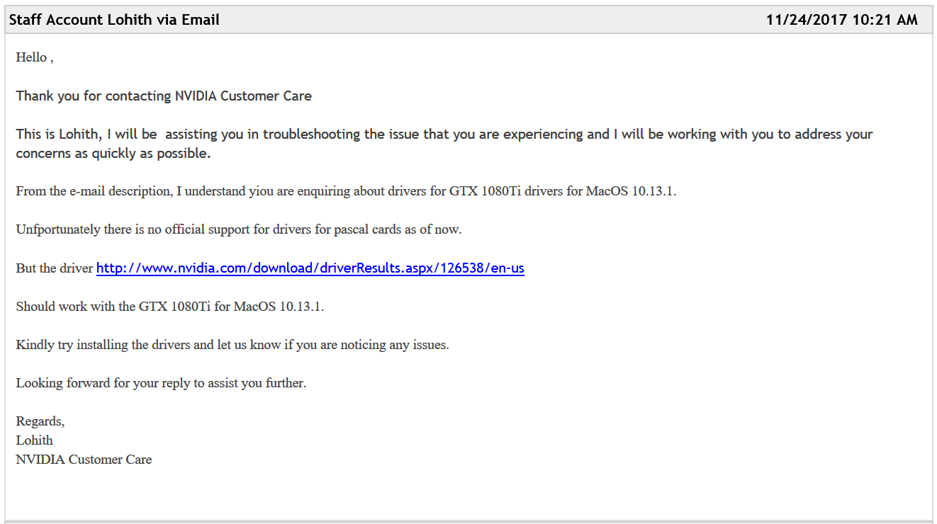

Nvidia Customer Care staff confirmed that the Pascal card "should work" but "no official support". I believe this also applicable to any GPU not on that "Supported Products" list as well. Or at least OP's 980 should be in the same situation because Nvidia never ever says give the Maxwell any official support in any OSX / macOS.

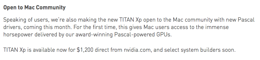

And again, I will refer you to this post I made a year ago:
^^^^Because those were the only "official" Mac cards sold that were issued as "Mac Edition". See this from Nvidia's web site concerning Pascal Cards.
https://blogs.nvidia.com/blog/2017/04/06/titan-xp/
Posted on 04/06/2017
If your too lazy to click:
Lou
